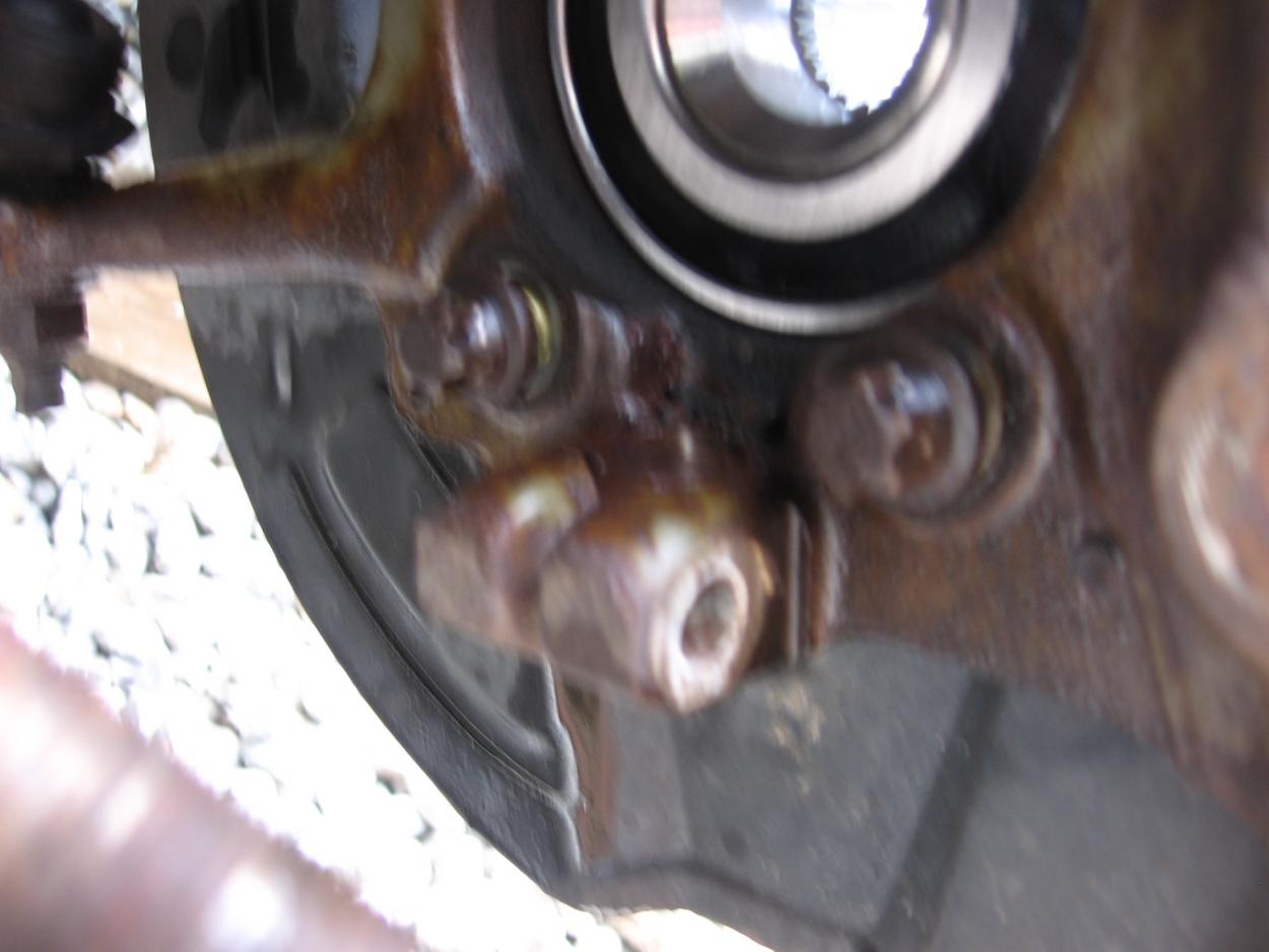

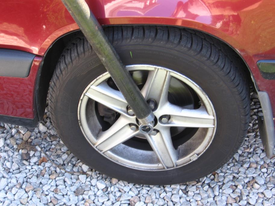

1) Before jacking up car, loosen axle nut (36mm socket) In the pic is my 4 foot pipe over socket to get extra torque. (image 1)

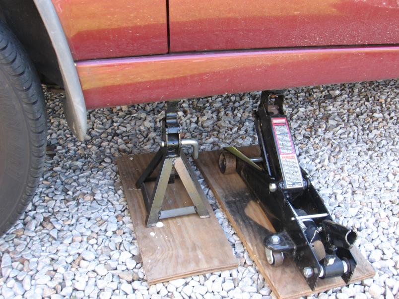

2) Safley jack up the vehicle and remove tire. (image 2)

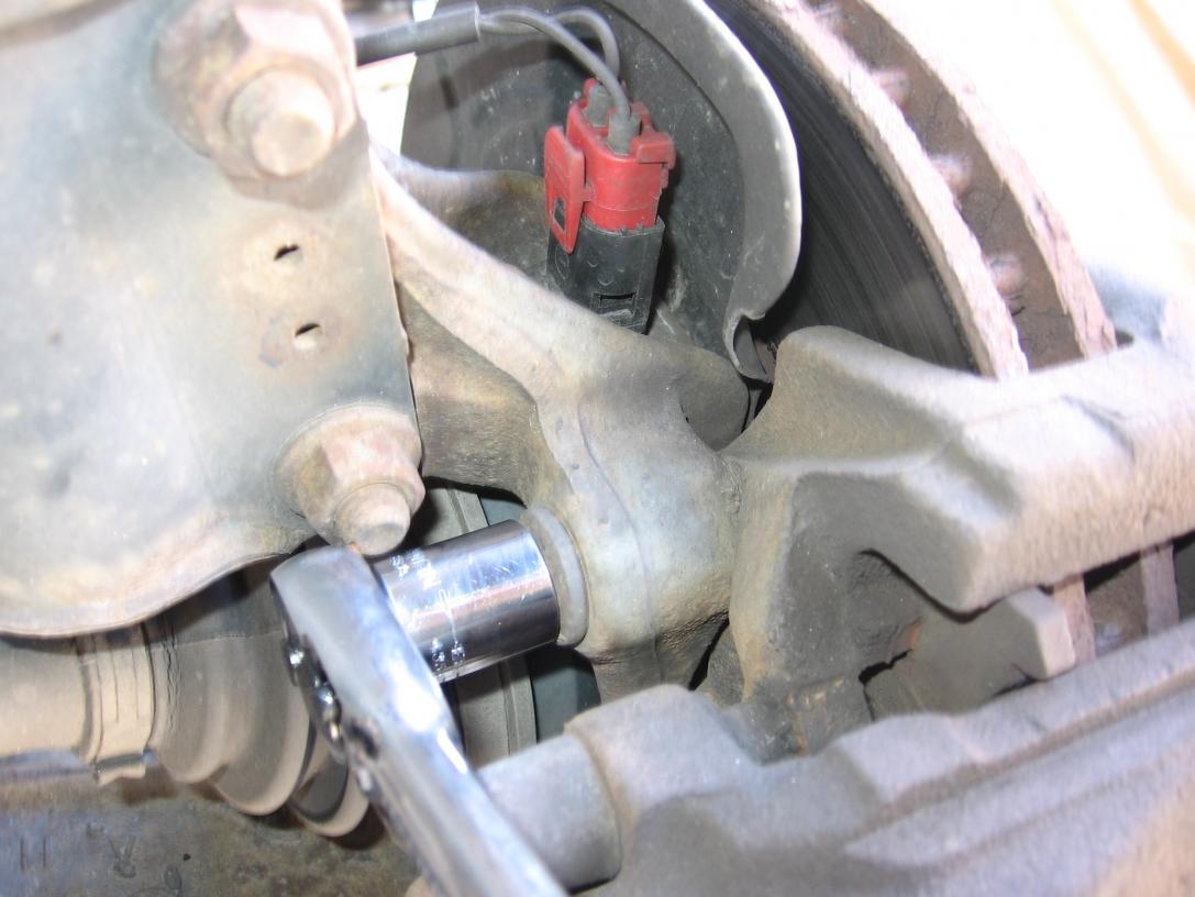

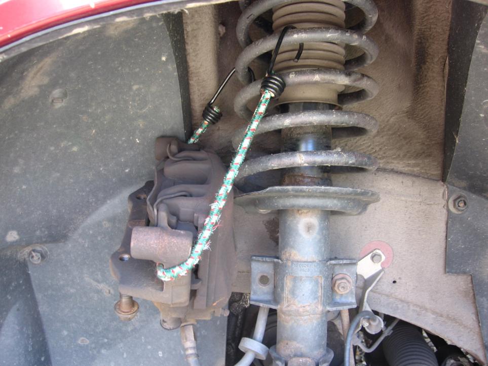

3) Remove 2 15mm bolts to remove the caliper assembly and safley secure it out of the way. (image 3 and image 4)

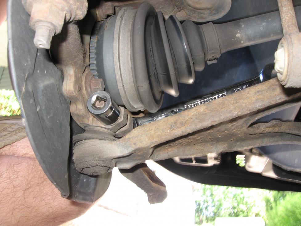

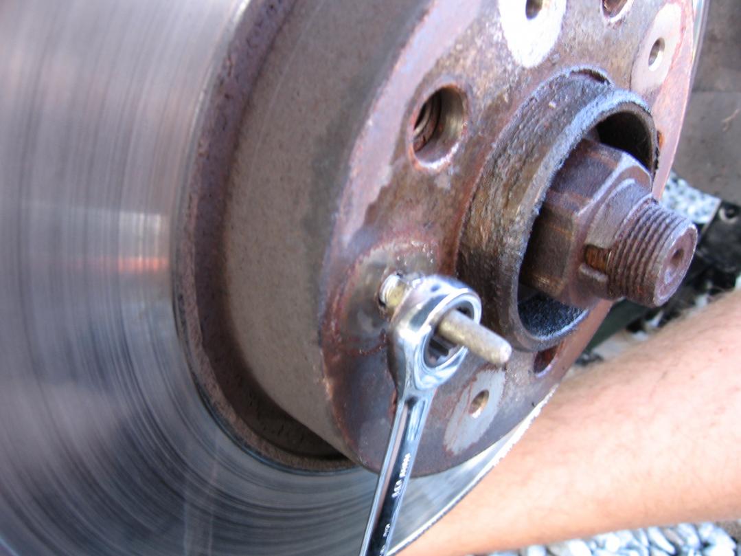

4) Remove mini stud in rotor with 10mm box wrench or deep socket. (image 5)

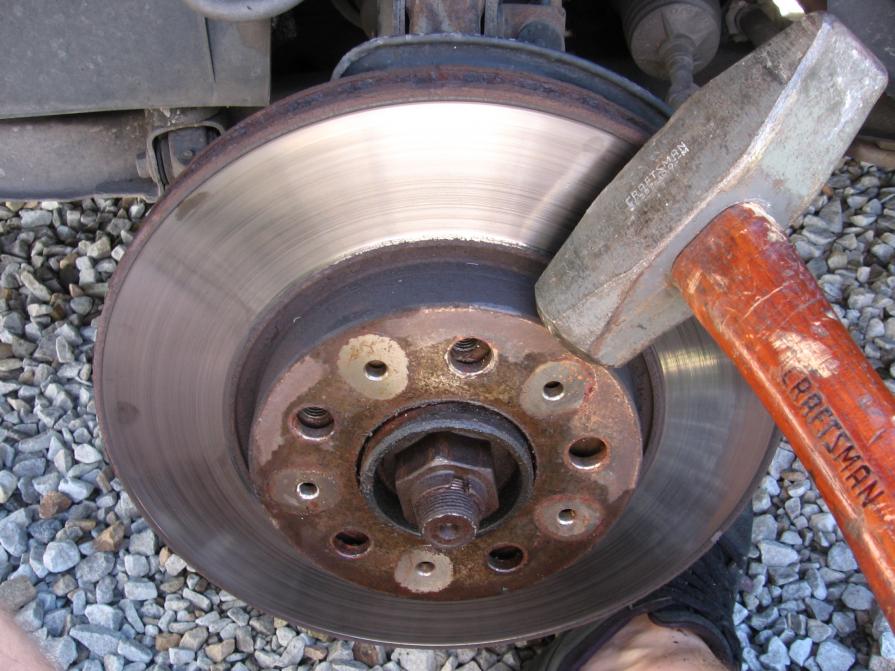

5) Remove Rotor. Take care of braking surfae is rotor is to be re-used. I hit center rim area and it popped right off. (image 6)

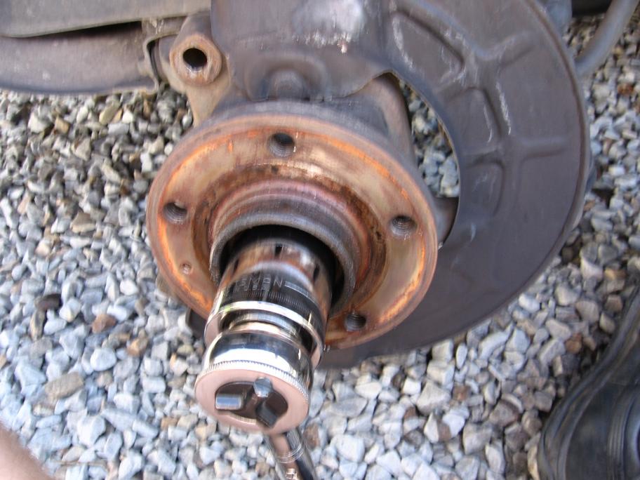

6) Remove axle nut completely (image 7)

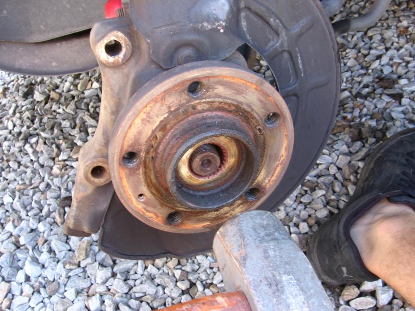

8) Wack out axle from the wheel bearing (image 9)
