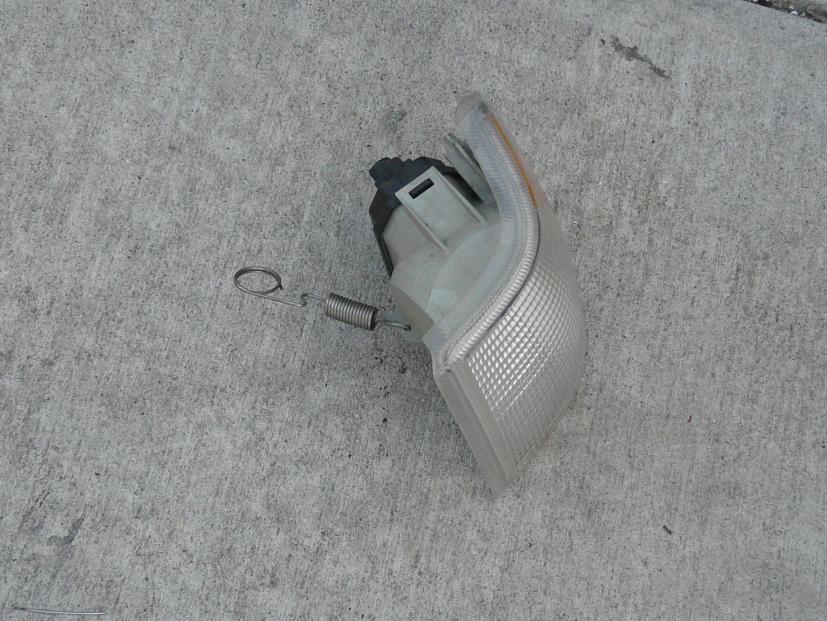

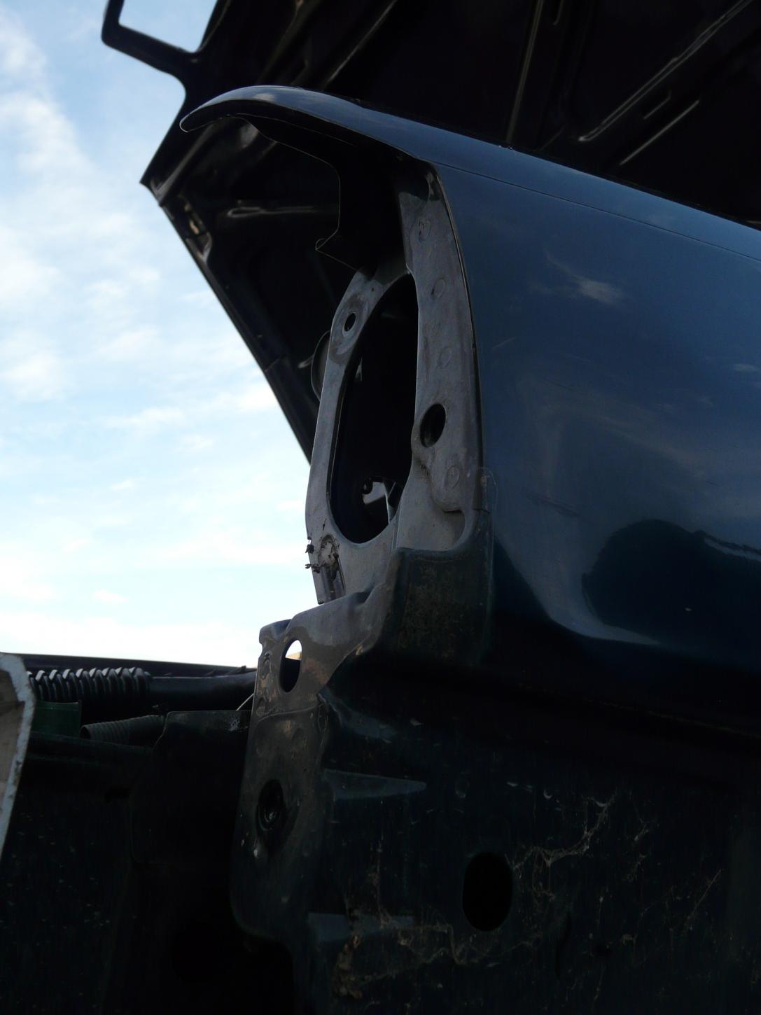

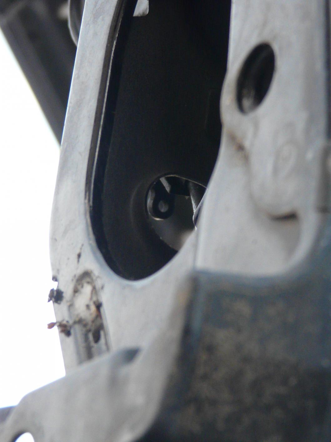

Here are instructions for opening the hood without a cable
1. You will have to remove your marker light...maybe you can even do this without removing it. Its spring loaded, you might be able to pull it out far enough to do this.
2. Take a look at the picture with the marker removed. See the hole in the well that makes its way into the engine compartment.
3. Next picture is zoomed in...see the little tab with the hole in it? Thats the release. Take a hanger and make a bend in it to grab that tab and pull...that should do it.

yup, thats the best way of going about it... good luck man.
do the driver side first because that releases the passenger side.
