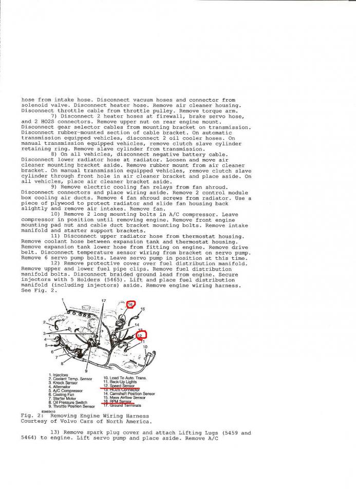

Here's a quote for 2-1-4. My service manual says it is Vehicle Speed Sensor (VSS).
1-3-1 (VSS Signal Absent) & 2-1-4 (VSS Signal Intermittent)
1) Connect measuring unit to ignition ECU. See MEASURING UNIT
under SELF-DIAGNOSTIC SYSTEM. To check VSS signal, connect voltmeter
between measuring unit terminals No. 1 and 2. Operate starter motor.
Voltmeter should indicate 300-400 millivolts with ignition switch in
START position and about one volt with engine running.
2) If voltage is not present, turn ignition off. Connect an
ohmmeter between measuring unit terminals No. 1 and 2. Resistance
should be 200-400 ohms, depending on temperature. Connect ohmmeter
between measuring unit terminals No. 2 and 20. About zero ohms should
be present.
3) Disconnect Camshaft Position (CMP) sensor connector to
prevent it from setting code. Use diagnostic test mode No. 2 and
recheck sensor signal. See DIAGNOSTIC TEST MODE NO. 2 under
SELF-DIAGNOSTICS. Operate starter motor. Code 1-4-1 should be
displayed (vehicle speed sensor). If code is not displayed, repeat
test using new ignition ECU.
4) If no electrical fault is found, ensure carrier plate is
not damaged or distorted. This problem, which applies primarily to A/T
vehicles, can prevent engine from starting and set a code.
I hope this is of some ref until Tech comes home.
JPN
Attached Thumbnails Volvo 850 RPM Signal absent-850-auto-gearbox.jpg   Volvo 850 RPM Signal absent-850-engine-removal-3-.jpg
