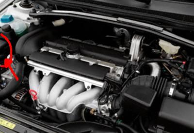

It is on the left side of the engine bay in side a black box. You need a tool to get it out. See attachment.
MAF is on the intake, right after the airfilter box, going to the Throttle mody.
Example of MAF:

Here is a link for MAF (Click Here) also try http://www.fcpgroton.com/
The tool is in the lower left side of the pic:

You do not need the special tool. It will make things easier if you use it but you don't need it.
There are two slides on either side of the ECU underneath it. You will need to push these forward one slightly at a time. Don't get one two far forward and the other not. Once they are far enough forward the ECU will put straight up and out.
