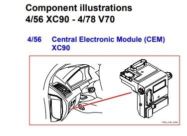

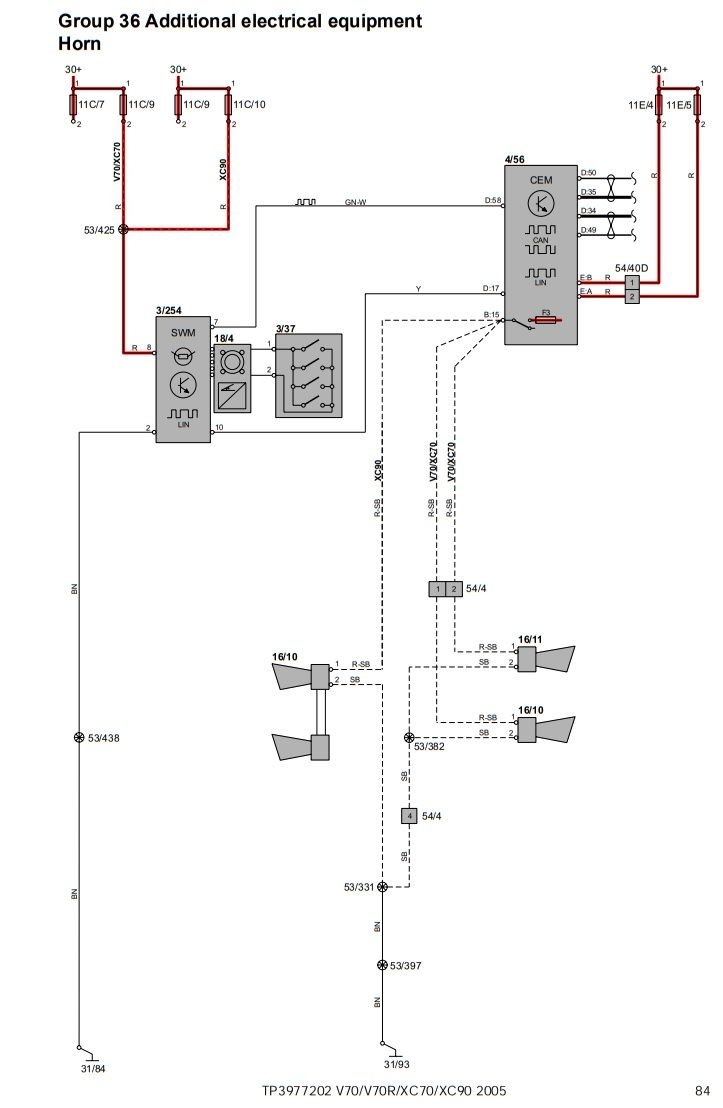

There is no relay - there is a fuse on the CEM, #3

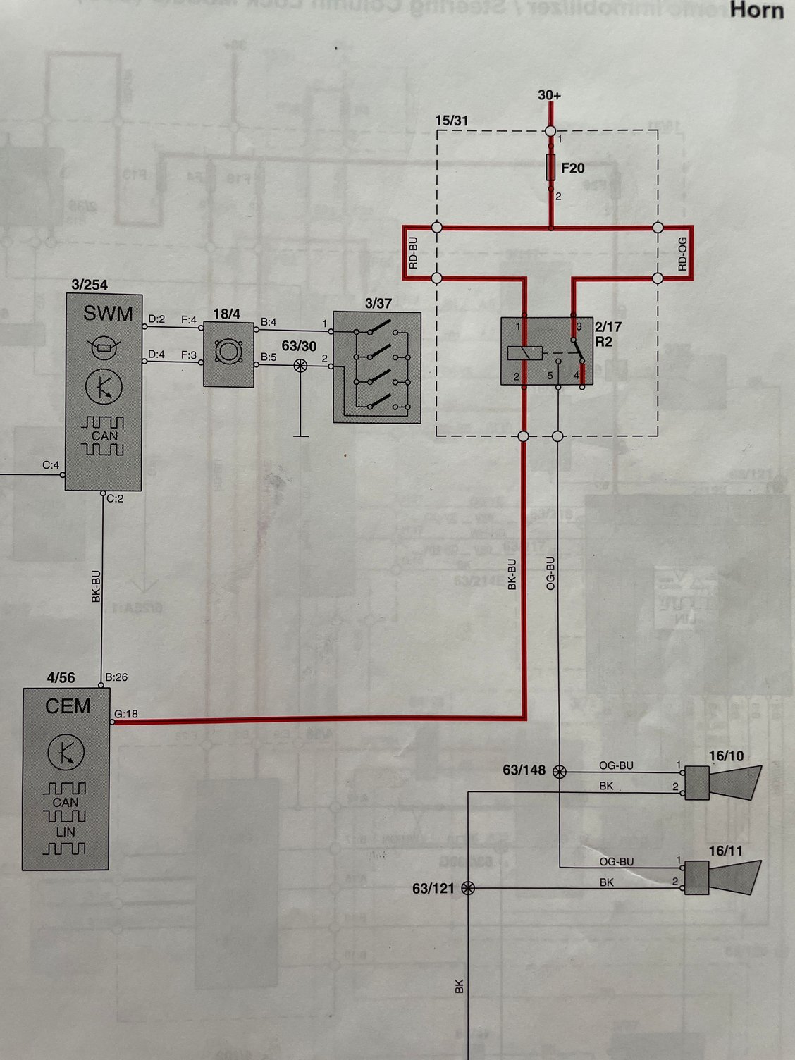

I greatly appreciate your response. However, the schematic is of no help. So is the fuse in the panel under the dash on drivers side?

The fuse (#3) is in the not easy to get to CEM

A solution could be to connect without CEM and SWM. Wire from relay 2 in the engine compartment to the steering wheel's contact reel
