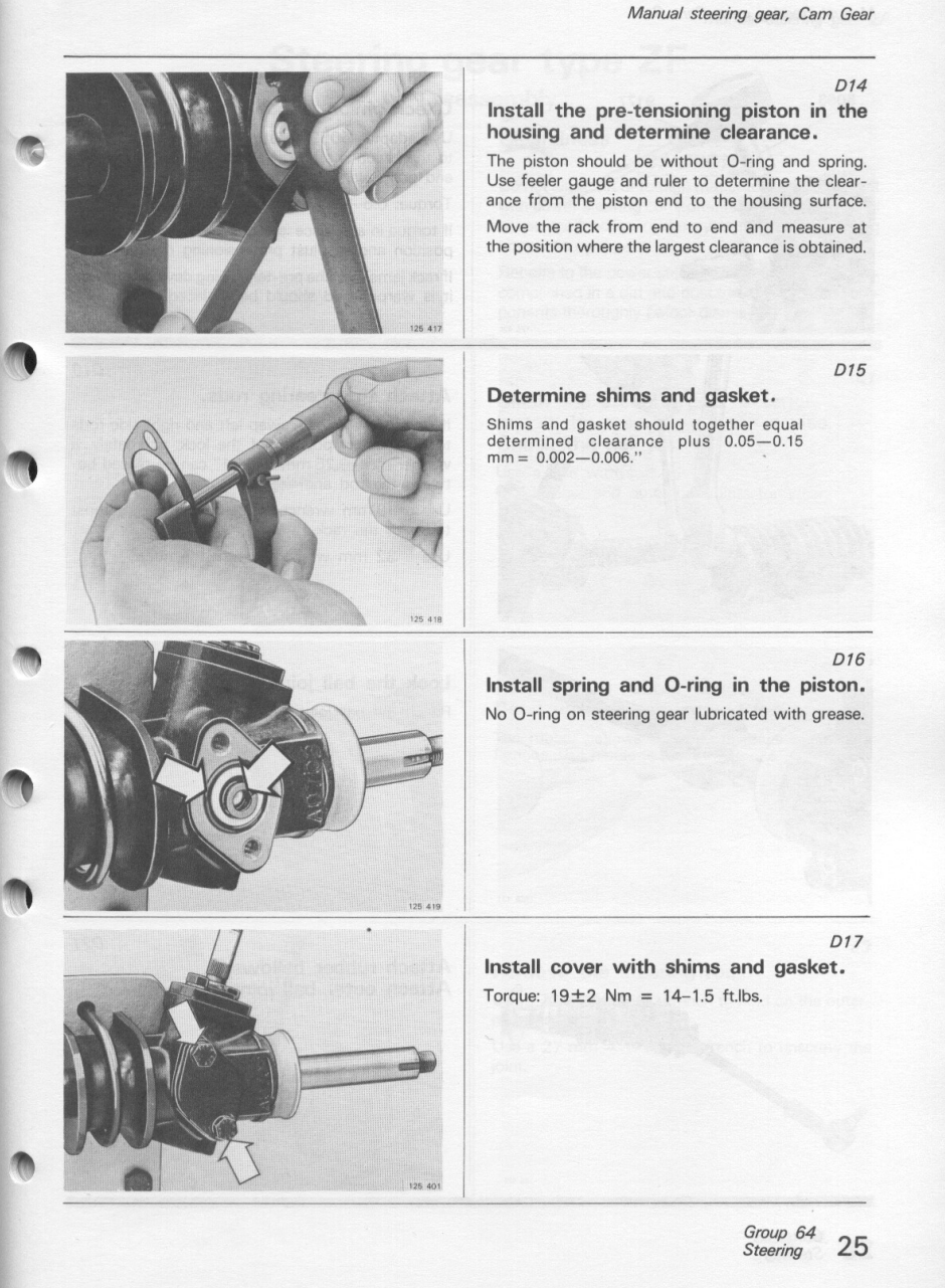

Definitely going to try this. I think I have some play in the steering rack so I'm going to have to see if the pre-tension piston can be tightened. Has anyone tried this?
