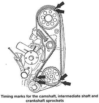

1 Attachment(s)
Most likely you didn't get the timing right prior to buttoning up the timing belt. There are 3 timing marks that have to be lined up: the crank pulley, the intermediate shaft w/ the larger gear off to the drivers side a bit above the crank and the cam shaft gear. Most folks get the crank and cam lined up and miss the intermediate shaft. As it runs the distributor it's rather important to get it lined up .
Attachment 20442

swiftjustice44 Oct 31, 2010 08:53 PM
Yeah, that's about the size of it. If it's any consolation, every one does it the first time. Don't know if you did it this way, but when you release the tensioner bolt, pry it out and then tighten it down again. That way you have plenty of slack and don't have to fight it. The marks on the timing belt may or may not be correct. Frankly, I don't use them as I've run across way too many that had incorrect marks. I use a socket on a breaker bar to line up the crank pulley. The others are quite easy. Take your time and get it spot on...one notch off is unacceptable.
