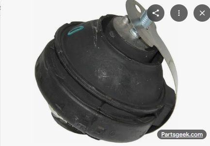

A common cause of vibration when idling is - Your car has hydraulic engine mounts. The mounts are pressurized and lose their "charge" and sag. Then the engine may rest against the subframe or if not, the vibration of the engine is transferred directly to the the subframe due to the flat engine mounts.
The solution is new engine mounts. If you grab the oil cap and try to more the engine left and right - with good mounts it will move, with deflated mounts it does not. Earlier cars you could tell by the placement of the water pump fan in the should - but a 94 has an electric fan

My new mechanic is replacing the motor mounts now. Thanks Should of posted two years earlier.
