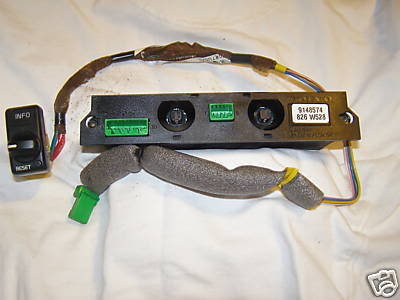

TacklaNHL Jul 23, 2008 12:24 AM
RE: Trip Computer vs. Clock & Temp
2 Attachment(s)
Ok, found it!!!
For the 1995 Volvo 850 with Yazaki cluster.... if you have the green socket on the back of your instrument panel you'll need this trip computer (along with the switch).
p/n: 9148574
Attachment 23561
Attachment 23562
