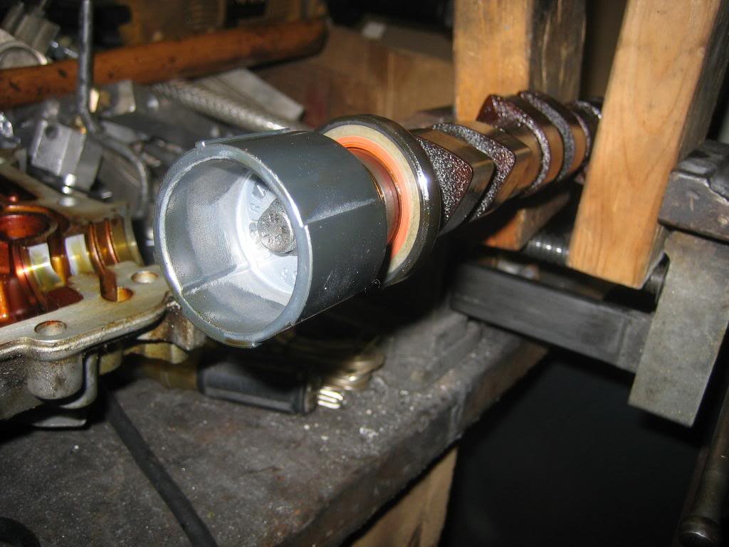

2 Attachment(s)
Yes, the rectangle looking thing on top of the exhaust cam, passenger side. It allows hot oil under pressure to enter the big CVVT gear on the exhaust cam. I have not read a single thread where cleaning has fixed the issue though. I always assumed the solenoid part has failed and no amount of cleaning will fix it. The CVVT gear could also have failed internally. The cam sensor is on the driver's side of the exhaust cam. It's inserted into the reluctor wheel cover and held by a 10mm bolt.
Here is the cam reluctor wheel cover. You can see where the sensor is mounted to the cover.
Attachment 16930
Here is what's under the cover, the reluctor wheel.
Attachment 16931
