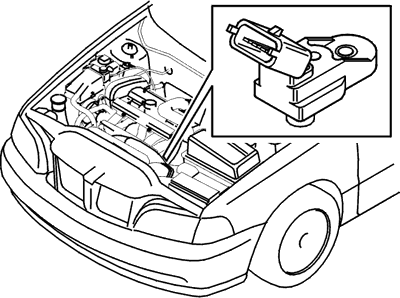

bw77 Apr 11, 2011 01:20 PM
There's a pic of the map sensor here:
2000-2004 Volvo S40 1.9 Turbo MAP Sensor
On the S70, the map sensor is on the intercooler pipe, just before the etm.

Hudini Sep 24, 2011 07:07 AM
bw77 posted a picture from the parts store on page 1. Slowbuttsure said "Unhook the electric plug, pull out the bolt on the MAP sensor, use a screw driver to pop out the sensor, and replace the new one." Based on the above I'd say there is no vacuum hose on the MAP sensor. It plugs into a hole on the intake (on the 2000 there is only one) and is held in with a bolt. You can clearly see the O-ring in the picture to seal from any air leaks.
