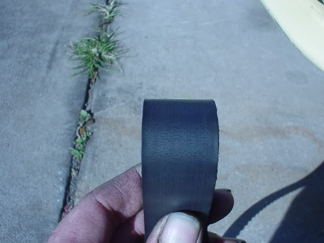

[/align]The post is to show why the timing belt should really be changed at about 70,000 miles instead of 105,000 like Volvo says it should be.
[/align]Also Make sure you replace the tensioner and idler pulleys as well.
[/align]I have some pics of belts I have replaced at work on cars.
[/align]I have the belts from a few of the different models the milage will vary between 70K and 80K. You will see how the belts crack at that milage.
[/align]I would not trust the belts like that on my own car. That's why I am making this post so that everyone is informed about the belts and what can happen if they break.

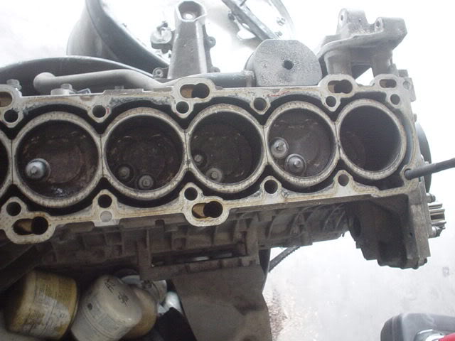

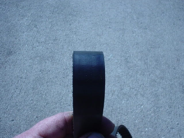

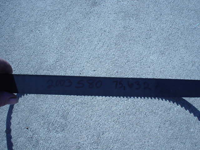

[/align]Now onto the pictures the first batch will be the timing belt pictures with the model,year and milage that they were changed.
[/align]Then the last batch of pictures will be an idler and tensioner pulley from a S80.(Not as bad as I wanted for an example picture but will work.
[/align]Then finally a picture of an engine that had the belt break.
[/align]
[/align]This way everyone has an Idea of the entire situation.
[/align]Then you can make your own decisions from here.
[/align]
[/align]The first belt is from a 2000 S80 with 72,623 miles
[/align]Attachment 24204
[/align]Attachment 24205
[/align]The second belt is from a 2003 S40 with 73,746 miles
[/align]http://img.photobucket.com/albums/v6...Picture005.jpg
[/align]http://img.photobucket.com/albums/v6...Picture006.jpg

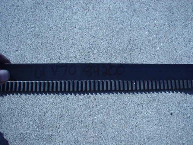

[/align]The last one is from a 2001 V70 with 82,700 miles
[/align]Attachment 24206
[/align]Attachment 24207

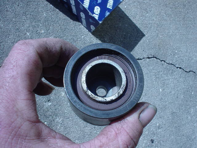

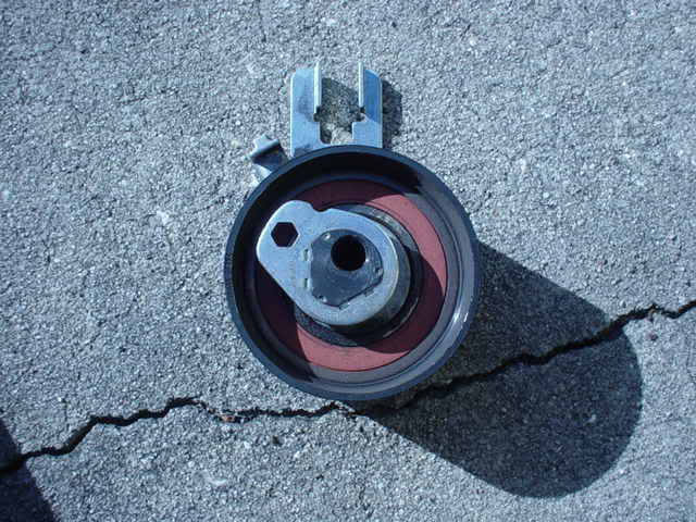

[/align]Here is a tensioner if you look closely in one spot you will see where grease started coming out of the bearing.
[/align]Attachment 24208
[/align]
[/align]Here is the idler same here both sides were spinning grease out.
[/align]Attachment 24209

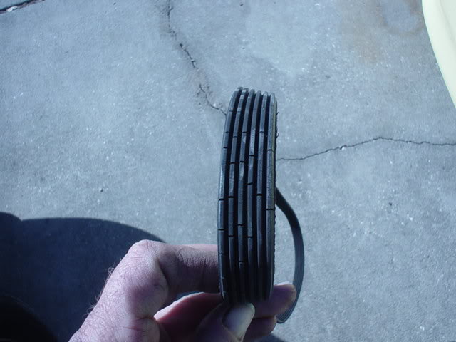

[/align]If your serpentine belt looks like this replace it I have seen them break as well and get sucked into the engine and break the timing belt as well.
[/align]Attachment 24210

Sorry here is the pics of the head and block
http://img.photobucket.com/albums/v6...9/Volvo008.jpg
Attachment 24211

That is quite a valve job! I've seen a few bent valves when the belt goes, but it looks like 7 valves broke! Lucky 7! Nice info and pics on the belts and tensioners!

The tensioner and idler are actually more important than the timing belt. The pulleys fail more than the belts do.
