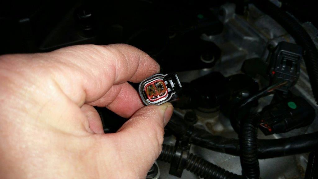

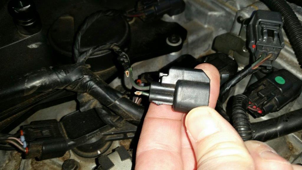

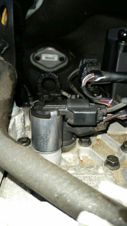

Good News and Bad News.
After painstakingly searching and testing, I located a wire going to my Variable Timing Valve Solenoid (???-I found 4 different names that this part goes by while checking various part sites). It was missing a 1 inch section of wire, hence the open circuit. Sabotage? No, probably a rat who took a liking to the flavourful Swedish wiring. A colleague recently had over $2000 in wiring damage do to a rat problem.
I was able to jump solder a wire but would like to replace the connector with a new pigtail wired connector.
