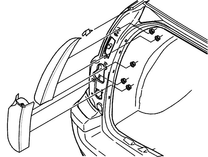

(1) Replacing a Tail lamp,
Removal
Common operations
Remove:
-The loudspeaker grille on the D-post. See
Loudspeaker, D-post, replacing
-The side panel cover. See Cargo (just pull the tab to expose the Circuit breakers) compartment side panel cover (no picture above)
-The cargo compartment side panel. See Side
panel, cargo compartment, replacing
-The cantrail panel. See Panel, cantrail,
replacing
-The D-post panel. See Panel, D-post, replacing
Upper tail lamp
(Must be removed before the lower tail lamp)
-Disconnect the connector
-Remove the nuts (2)
-Remove the tail lamp and the end piece for the cover strip in the roof joint
-Remove the end piece.
Lower tail lamp
-Remove the upper tail lamp. See above
-Remove the nuts (3)
-Remove the lamp
-Disconnect the connector.
Installation
Tail lamp
-Install the lower tail lamp unit first if necessary
-Everything else is installed in reverse order.

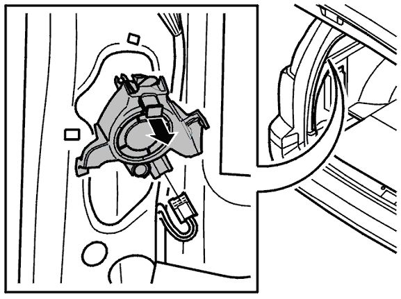

(2) Removing the loudspeaker in the D-post
-Detach the loudspeaker grille by releasing it
at the lower edge and pulling straight downwards
-Pull out the clips
-Angle out the loudspeaker. Disconnect the connector.
Installing the loudspeaker in the D-post
Install: In reverse order.

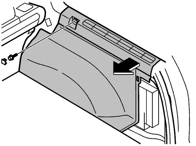

(3) Removing the cargo compartment side panel
Remove:
-the side panel cover. See Cargo compartment side panel cover
-the blind cover plug (cover)
-the screw.
Caution! Grasp the rear edge so that the clips
release. Change your grip and pull off the clips
by pulling forward.
Fold the panel down so that it is parallel with the
floor and lift upwards.
Installing the cargo compartment side panel
Caution! The floor hatches must be removed
before the panel can be installed.

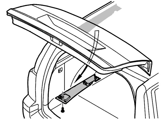

(4) Removing the cantrail panel
-Remove one screw
-Pull the panel straight down.
Installing the cantrail panel

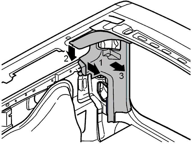

(5) Removing the D-post panel
Remove:
-The cover for the side panel. See Side panel,
-the cantrail panel. See Panel, cantrail,
replacing .
Caution! Detach the panel in the following order.
Otherwise the panel may be damaged.
-Grasp the edge. Pull inwards so that the clips
release (1)
-Detach the upper edge at the window so that
the panel can pass the gas strut (2)
-Pull inwards so that the clips in the opening
release (3)
-Lift upwards.
Installing the D-post panel
Note! Align against the sill trim panel and the load securing eyes.
