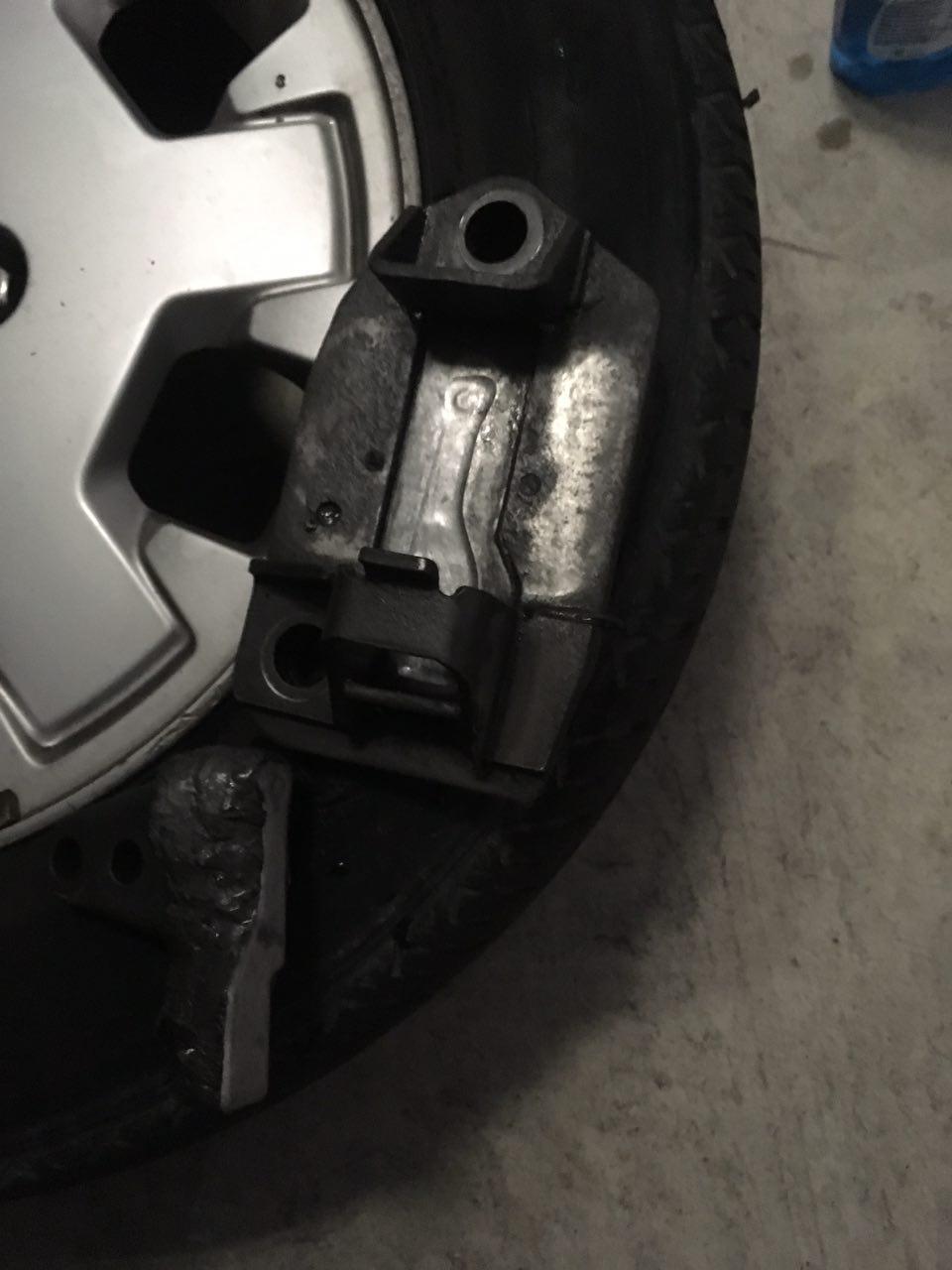

Alright... this car has been through hell and back, and she keeps going like a champ. I'm trying to ensure it stays that way.
The passenger motor mount was making some death-impact noises so I pulled her apart and found the issue... the mount pretty much was nonexistent. Have a look:

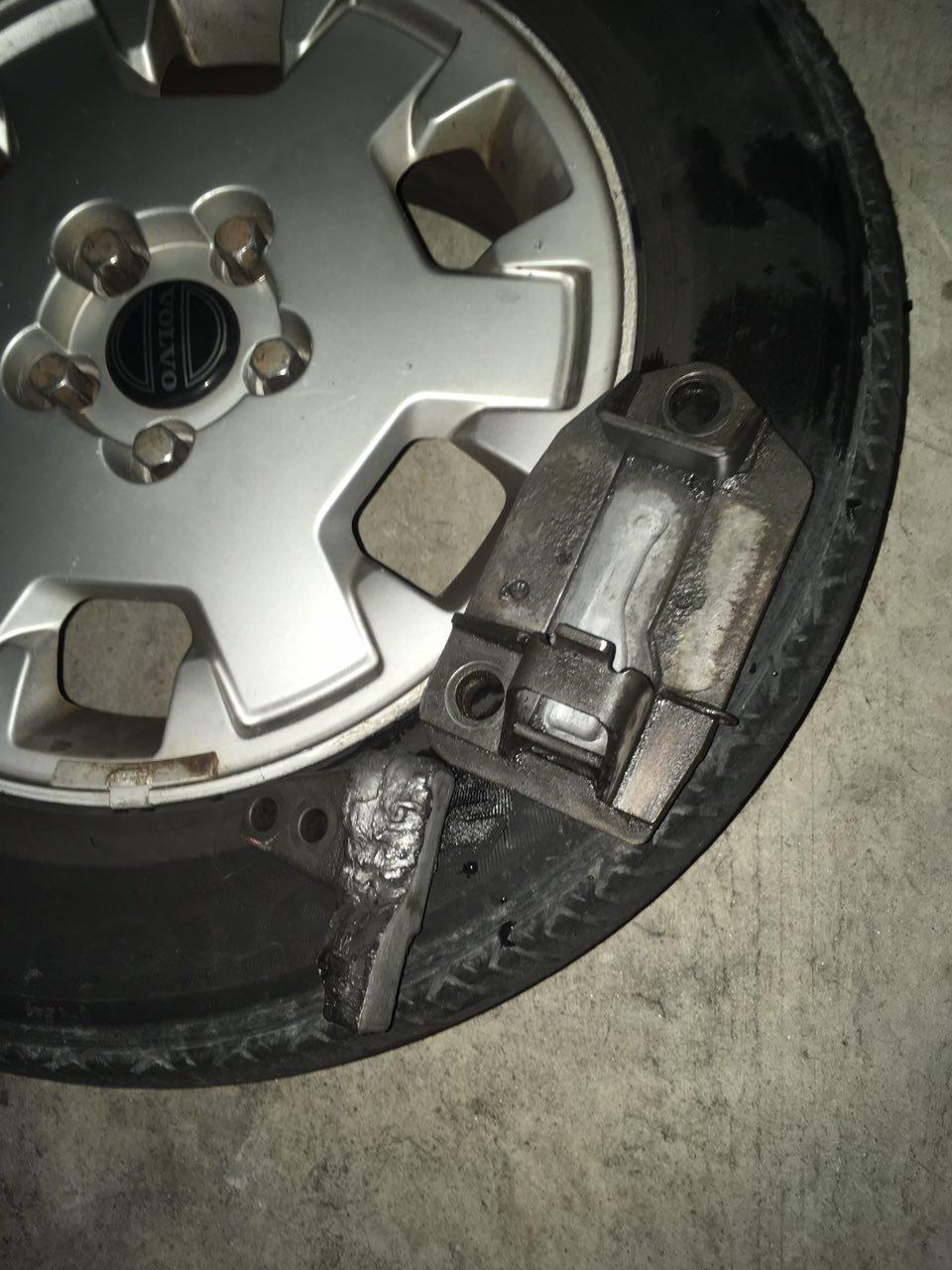

I cleaned the mount up just to see what I was working with:
Attached Thumbnails 2000 V70xc - Motor Mount Fix-clean-mount-1.jpg   2000 V70xc - Motor Mount Fix-clean-mount-2.jpg

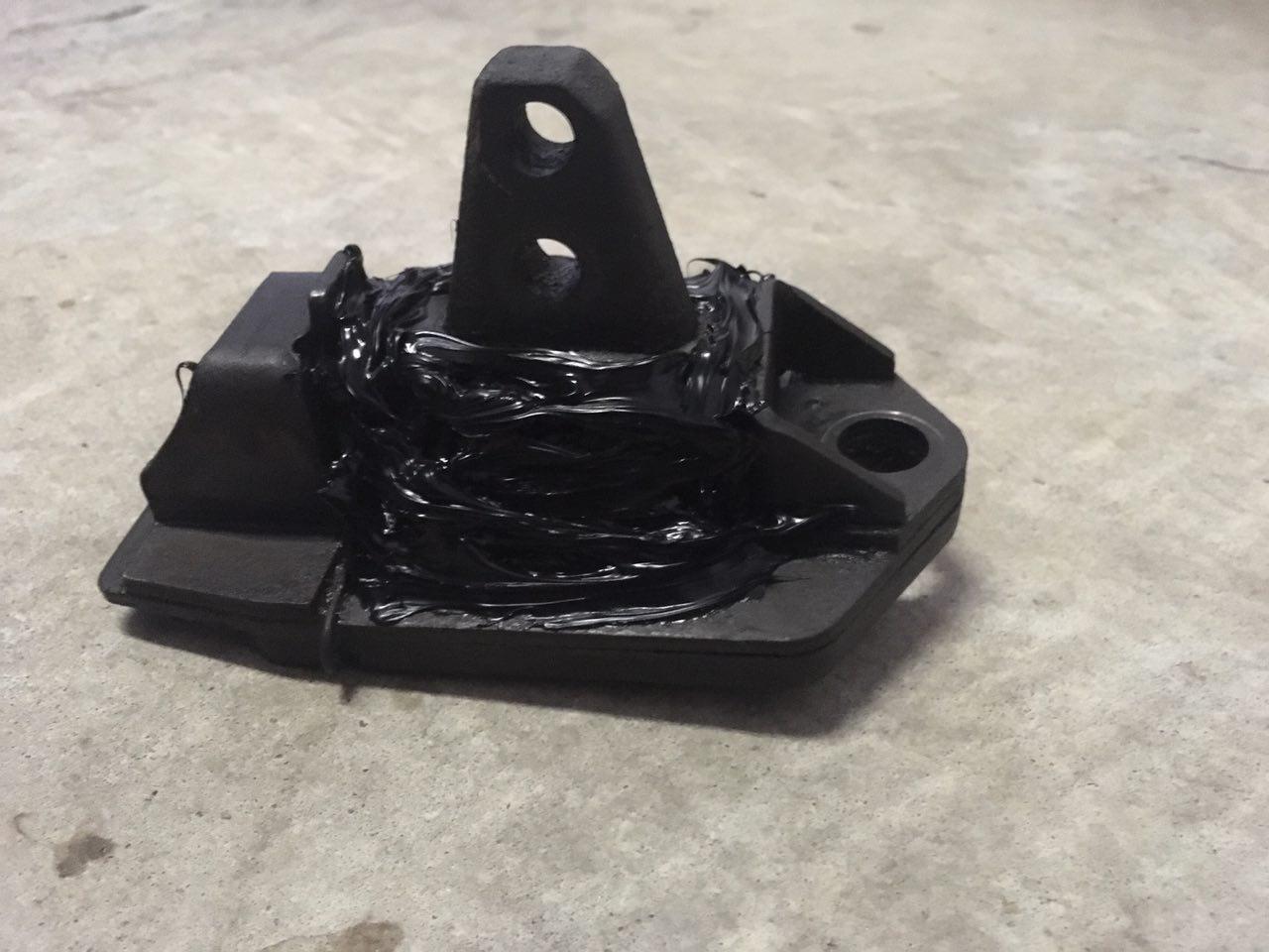

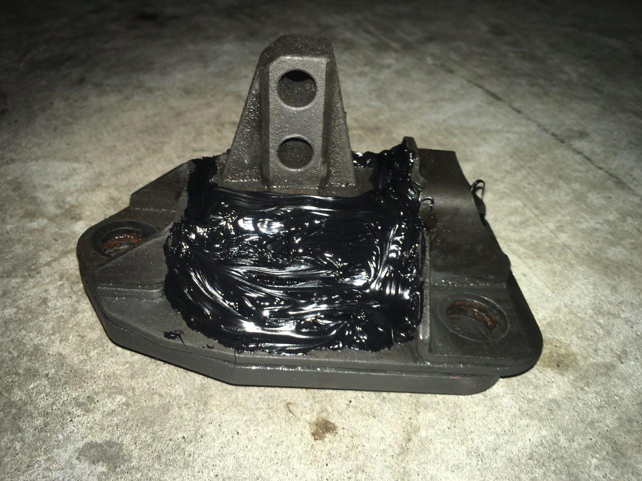

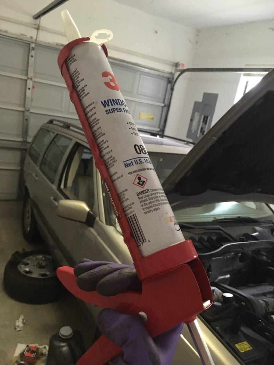

After that, since I was on a very tight budget, I decided to try to rebuild the thing with some good ol' 3M Windo-Weld. Urethane motor mounts on a budget (Or so I was told)!
Now it's time to let them cure and see what happens. I'll let them sit for 24-48 hours and reinstall on the car and take it for a drive.
Attached Thumbnails 2000 V70xc - Motor Mount Fix-windo-weld.jpg   2000 V70xc - Motor Mount Fix-rebuilt-mount-1.jpg   2000 V70xc - Motor Mount Fix-rebuilt-mount-2.jpg

I'm going to put the mount back in the car today after work and take it for a test drive.
I'll let you know how it goes and rides.
I also plan to follow up with post updates to let you guys know how long it lasts, since nobody on any forums seem to have that information.
The Windo-Weld costs $30-$35 at Orielly auto parts, and there seems to be no other brand that makes a similar product.
