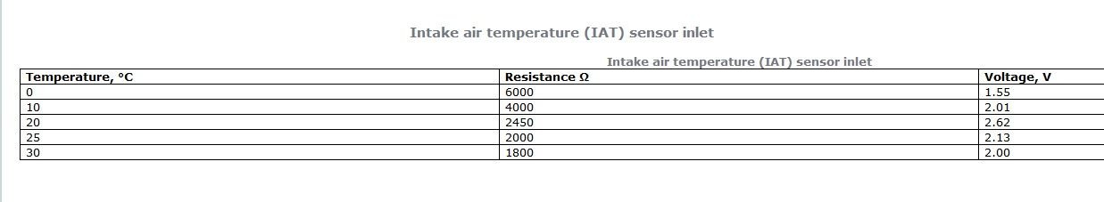

My MAF is a Denso 1275636 and the live data I can read gives the IAT of 31C (with an outside air temperature of 7C). Presumably I can read analogue voltages (with a meter) from the MAF connector and/or resistance values from the disconnected MAF.
a) Does anybody know where I can find a wiring pin-out for a Denso 1275636 MAF?
b) If the MAF turns out to be faulty, is the IAT sensor part repairable? A new MAF from Volvo is very pricey and it would be a shame to scrap my MAF for the sake of a 50c thermistor.
c) How much effect will a failed I.A.T have on performance?
