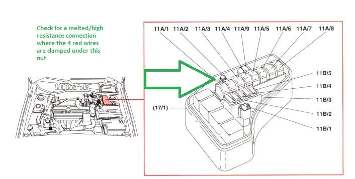

Most of those electrical functions (except the horn) get their power from relay 2/30 in position 105. Note that relay powers fuses 30-36 and 37 which is a circuit breaker for the windows. When stuff is not working check for power at those fuses. Current goes directly from terminal x on the ignition switch to turn relay 2/30 on. Perhaps there's a relay with the same part number on it - to swap and test with. (106 might be the same )
And/or - check for melted/high resistance connection under the nut that clamps the 4 red wires coming from the positive battery terminal. Have found many melted wires under that nut in the fuse box.
This is it. Replacing relay was what my V70 needed. Million thanks to you.
