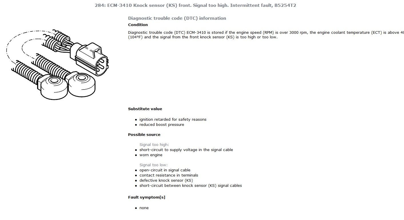

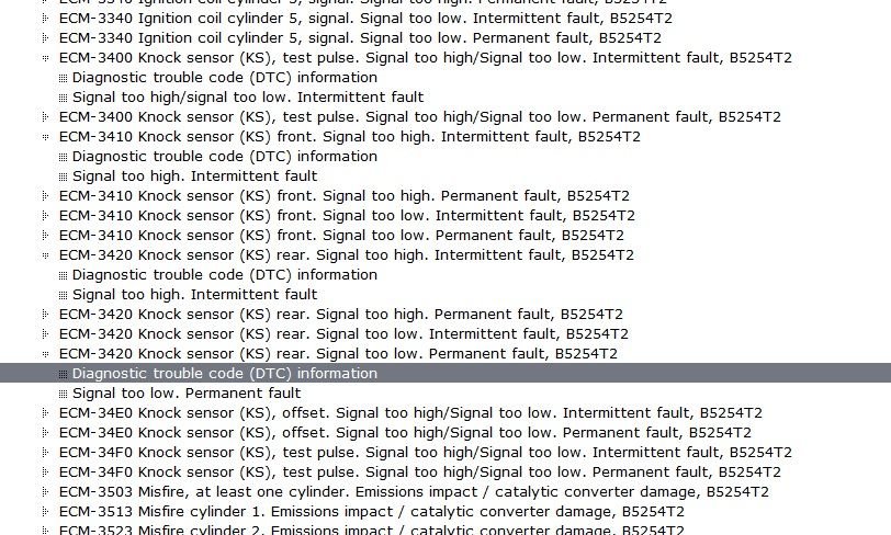

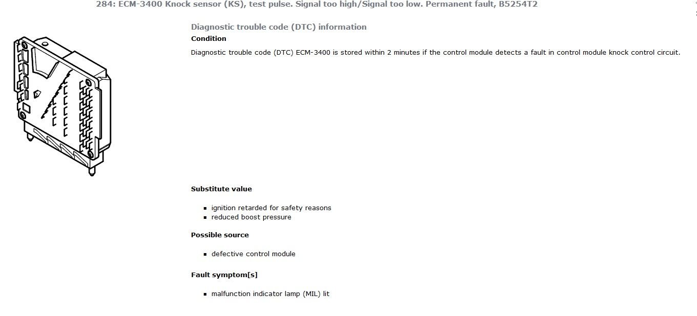

There are two knock sensors mounted on the front of the block. Never had to replace a pair. You might want to diagnose your problem rather than simply replacing parts that you think are bad. A knock sensor code does not mean the sensor is bad - it means the control unit does not like the signal from it. Here's a list of knock sensor codes that VIDA has, and for one of them (ecm3410) a list of possible causes. Note "worn engine" is a possibility and the Fault symptom is "NONE". In other words the knock sensor does not change the way the car runs, at least in a perceptible way. Next picture - note that a code 3400 could indicate a problem with the ECM.
