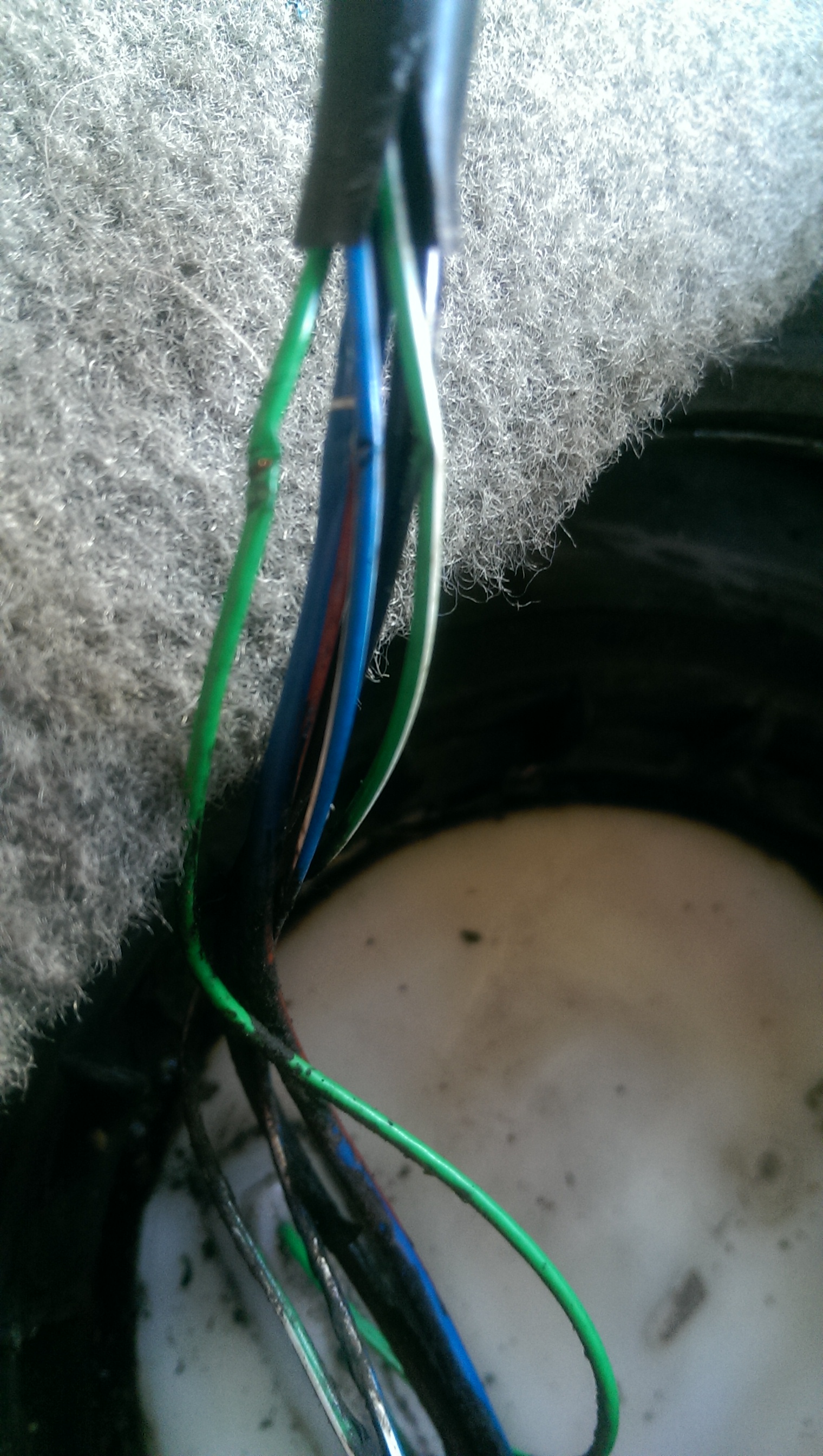

Old Dec 10, 2015 | 02:33 PM
musicman's Avatar
Joined: Nov 2015
Posts: 18
ES6T,
I want to thank-You for all your help !
I am a bit stubborn lol
So there was no power going to the fuel pump, but it had nothing to do with the fuel pump itself. I pinched the wires for the fuel sender under the access panel and shorte
d out the system, luckily it only blew the fuse ! Repaired wires and replaced the Fuse and waaLaa she started right up 😊
