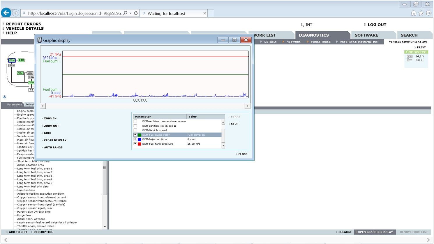

If the ECU is getting bad inputs - the self diagnostic will know that - and with vida you can view live data.

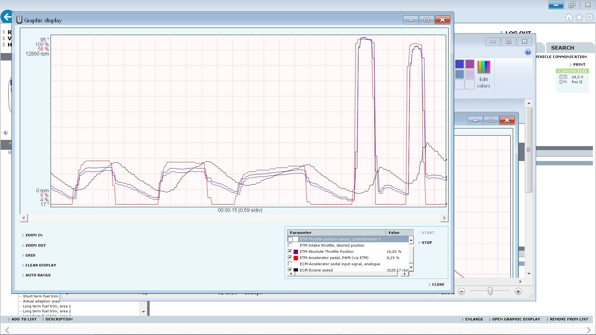

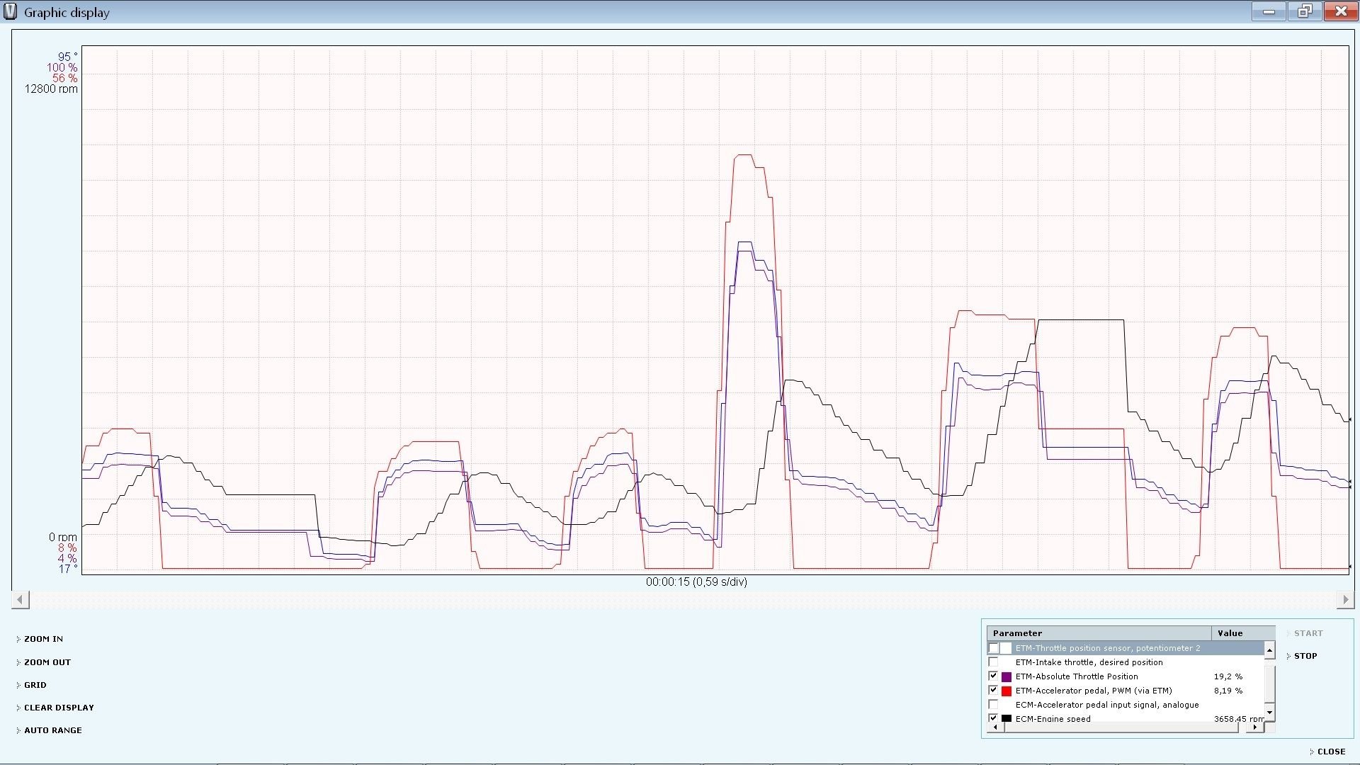

Old Nov 20, 2022 | 02:52 PM
Originally Posted by 3kocur
Some recommendation/idea?
Engine reacts slowly to press the accelerator.

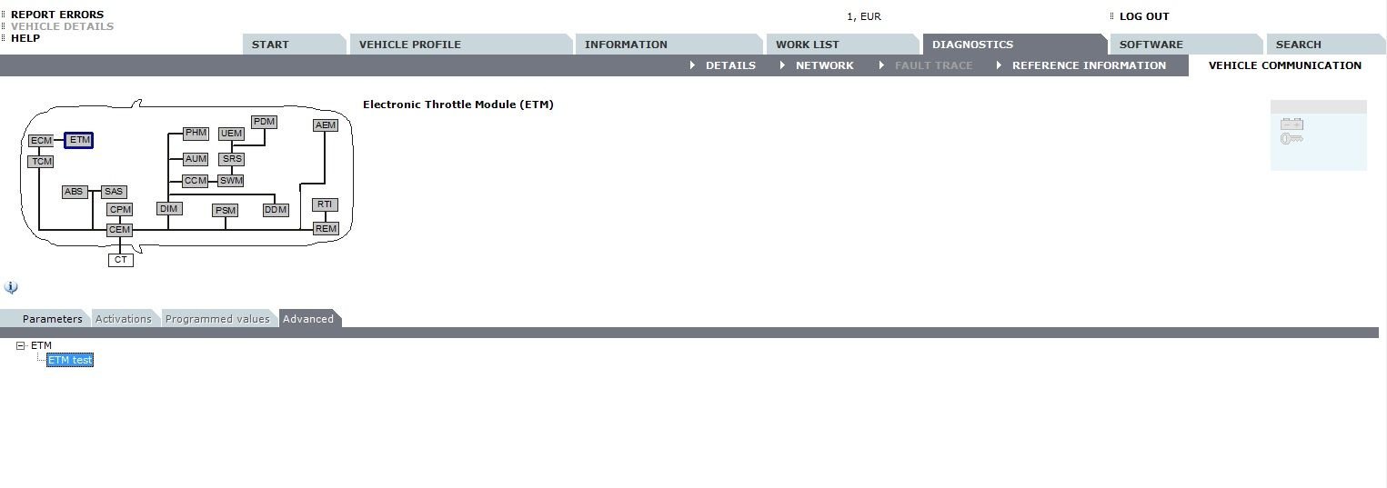

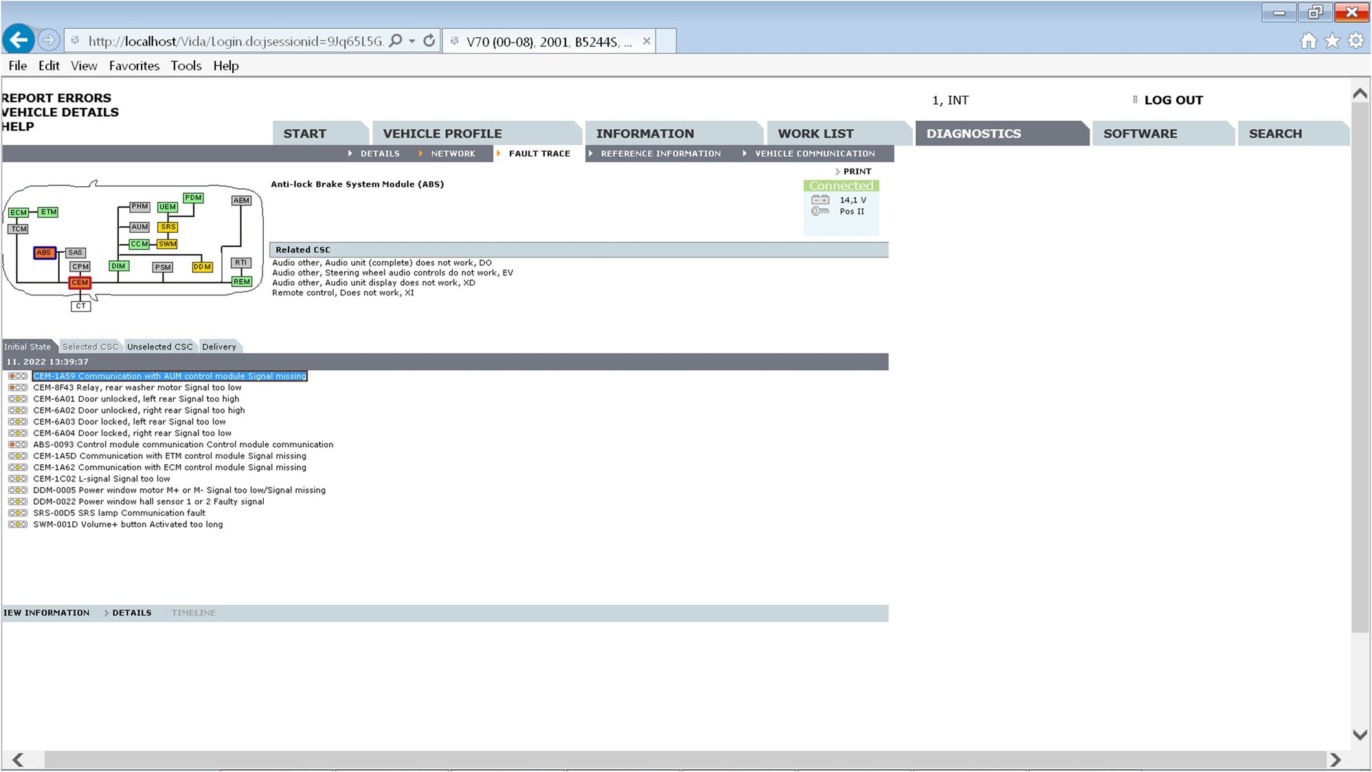

Yes - note there are no ECM or ETM codes - but there is a CEM code for communication with the ETM. Click on that code and follow the diagnostic suggestions VIDA has. That might guide you to a solution. And under Vehicle communication, click on the ETM module and under advanced run the ETM test. (pictured below, my modules are all grey because I'm not plugged into a car). I trust you are aware that the Magnetti Maerelli (sp) throttle module used on your cars - have a 100% failure rate. How old is yours? If old I would suspect that to be a problem.
Clear all codes and see what comes back.
If you need a throttle module they are coded to the VIN of the car. Some have reported getting used ones to work - I have never tried. If you install a new one - that requires a software download using a VIDA subscription to make it work in any car (your stolen/hacked 2014d can't do a software download).
I have used xemodex in canada hundreds of times for module repairs. For most modules they will program it for your VIN at their factory. A download is not needed. I know that's not close to you in eastern Europe. But here's a link for info. https://xemodex.com/us/electronic-th...etm-for-volvo/
Perhaps there is someone closer that performs the same service - That is convert to non contact potentiometers in that style throttle housing, and program a different Throttle module to your VIN if needed. .
