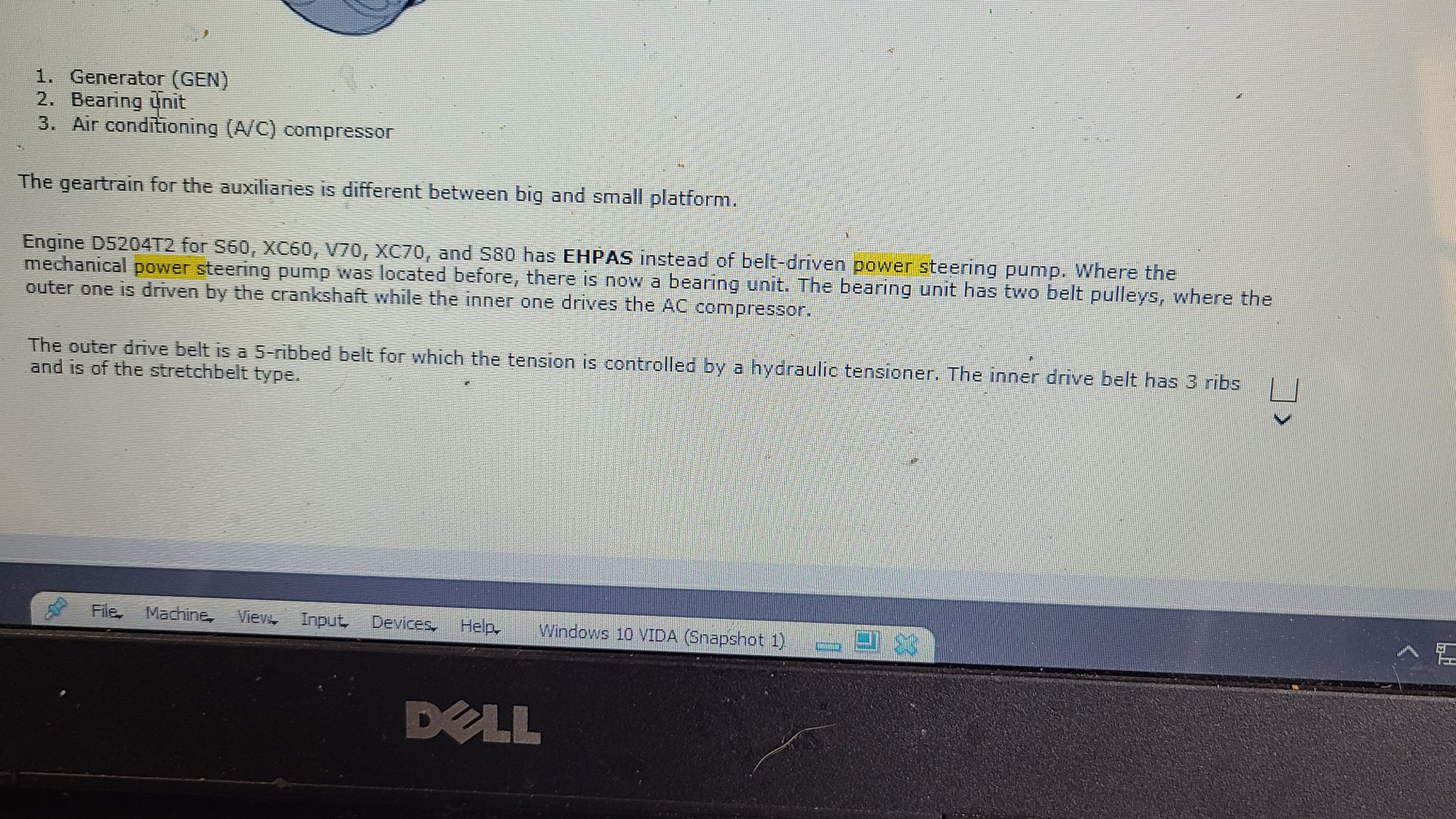

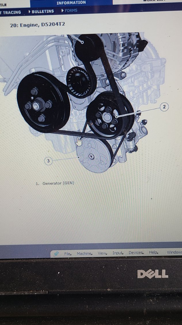

However,, I'm looking at vida right now, and if yours is a D5204T2 engine, it has this to say
so I suppose I have no idea what it would sound like.

Hi and thanks for your reply, Yes Engine is a D5204T2.
I wasn't and still not certain if PAS pump or Alternator pulley clutch was having issues causing this noise, strange that it occurs on engine starting up then just stops after about 8-15 secs. Also the headlights dim when turning on to full lock which I gathered was an Alternator issue so thought it could be that, but again not sure.

ok, diagnosing the old fashioned way, what I would try is with the Car off, putting a socket on one of the nuts of any of those wheels and turn it and see if any of the pulleys or wheels don't spin with the belt when it's being driven. or, loosen the belt and try all the pulleys individually and see if any are locked up or feel like they're on their way to seizing. that should help you narrow it down.
if you find one, give it a good blast with wd 40 or something (don't get it on your belts though!) and see if that helps temporarily. if it does, and comes back, you need to replace whichever part it was
