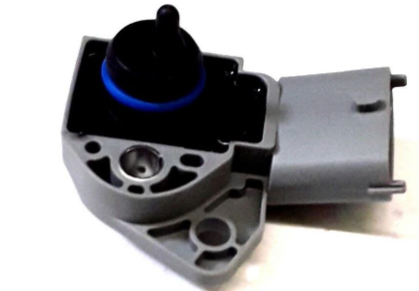

2002 should not have a fuel pressure sensor on the end of the fuel rail - The fuel pump runs all the time at full speed. There's no fuel return line so the fuel pressure regulator is part of the pump.
If there is a fuel pressure sensor on the end of the rail, a 31272730,
the pump only runs as needed. That function is controlled with a fuel pump controller, originally mounted on the side of the gas tank near the rr wheel. The controllers were exposed to the elements and I have replaced many that corroded and failed, causing - no fuel pressure. Volvo moved them inside the car in later years. Fuel pump is located under the 2 panels under the back seat.

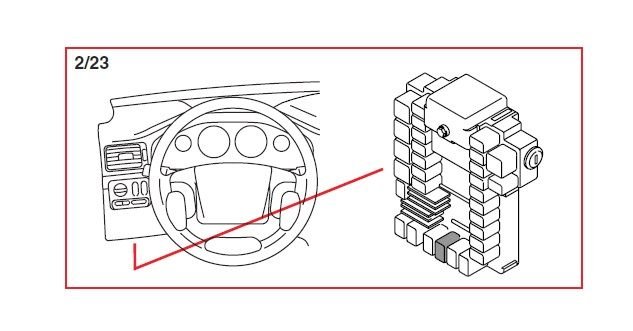

Here's a partial fuel system wiring diagram - 2/23 is the fuel pump relay mounted on the CEM under the dash,(most relays are the same, simply swap them if you think one is bad), 6/33 is the pump (for a car with no fuel pressure sensor) And TAKE A PICTURE of your CEM before you start moving or unplugging things - there many empty spaces.
