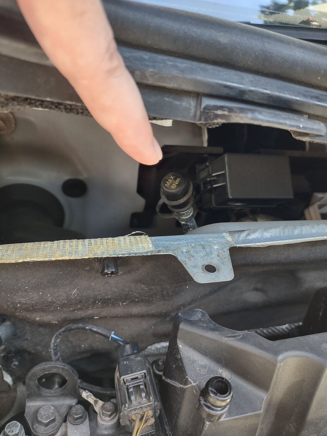

In case this helps anyone that comes across this thread. The key to finding the low pressure port is to remove the plastic cover that is directly over the firewall. This wasn't too obvious to me.
It's the cowling that covers the windshield wiper motors. It's held in place by 4 or 5 autobody clips. On the XC70, you need to remove the rubber weather strip that covers the battery cover, and the cowling and runs the full width of the engine compartment. With the weather strip removed, you can pry up the autobody clips (carefully).
Then you can access the low pressure port directly in front of the passenger compartment (under the plastic cover). The photo shows the hose connected to the
This next photo shows the cowling lifted up with the hose connected.

Yep, that's it. What did you remove when you first said you removed the cowl cover but it wasn't there?
