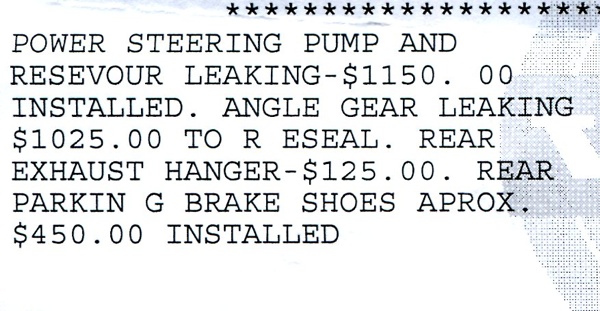

Since then I took it in for a routine $50 oil change at the only Volvo repair shop that I know of in the area. Nice place. Washed and cleaned out my car. Great waiting area with free bottles of water and coffee, say nothing of all the new 2013s I got to looking at on the showroom floor *some snazzy rides!*.

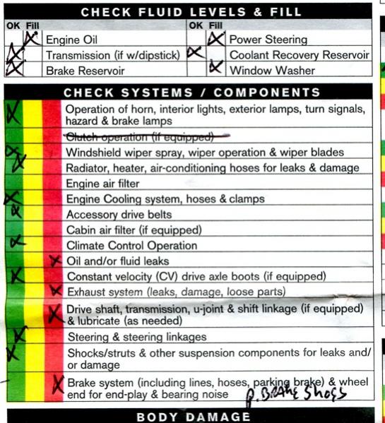

The chief mechanic came in to tell me my car was finished... as well as the results of their 50 point (or however many point) inspection of my ride... all that had an estimated cost of $2750 worth of repairs and an assumption that I'd want to get it all fixed that day.
Not made of cash and in need of doing other things with the rest of my day I respectfully declined.
The estimate and repairs needed can be found in the attached files
SO...
Question 1: What are the chances of being able to knock down the cost of repairs if I were to go to... say... a more general non-volvo-specific garage?

Parking brake shoes are way overpriced. The shoes and retaining springs are about $95 and labor should be about 1.3 hours.
The power steering reservoir and suction hose are common to leak. The pump usually just seeps. A non-volvo shop should have no problem doing either. Just make sure they use the right clamps.
I would not let a shop not familiar with Volvos (specifically the procedure to rebuild the angle gear) touch the angle gear. There are quite a few special tools to get the seals in at the correct depth, as well as an updated procedure to modify and reseal the case half.

Excellent. Thank you. My next question is how urgent do you suppose it is to get the angle gear repaired? He said it was leaking but didn't really hint one way or another as to how bad.

Depends how bad it is leaking. You don't want it to run dry and damage the angle gear, which is about $2000 new if I remember correctly.

If someone presented me with that estimate I'd have a hard time not laughing. That was a pure fishing expedition on the off chance you would bite.
It's amazing how much you can learn just by Googling around. Oil seepage from the angle gear is very common due to the poor seal design. It's possible that you may never have to have this repaired but you'd have to monitor it yourself for a while to figure that out. Read this thread.
The one thing on that list I'd fix right away (assuming it's actually broken) is the rear exhaust hanger. Probably just a missing rubber donut. $5.00 part and one minute's work - well worth the $125.00 you were quoted - not.

Seepage is one thing but I see a lot of angle gears leaking badly. If its seeping, I note it and advise the customer to keep monitoring at. It its leaking, I recommend rebuilding it. But then, I'm one of the honest ones.
The rear exhaust hanger that breaks is usually not the rubber part. Its the metal parts that go through the rubber hanger. They make a service bracket, as opposed to replacing the whole thing. Its about $74 for the part.

Bonus: I noted your problems with your power steering pump. When I still had my S60, the pump went bad also, but the dealer suggested replacing it with a used part. The $1,150 figure is for a brand new pump, which I wasn't willing to do. Instead, the dealership got me a used pump with a 12 month warranty for $200, which they put in for another $200 (including flushing and filling the system). I was a lot happier with that, and the pump worked fine for as long as I had the car.
