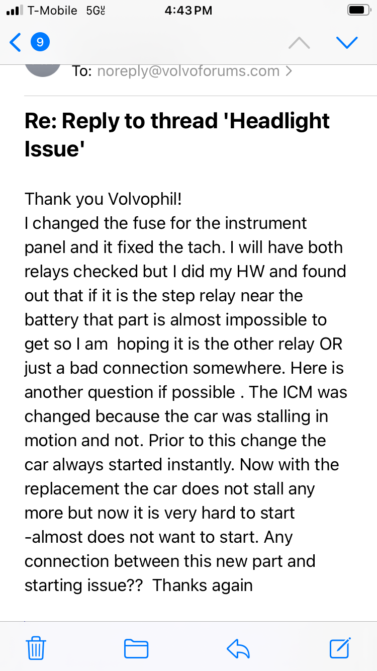

On a 1986 245 .Had the ICM recently changed and now the tachometer and headlights do not work . Any connection? I can deal with no tachometer but where do I begin with the headlight issue . Parking lights work , low beams do not and high beams stay on but moving the lever do not turn them off. Please offer any help possible Thank you
