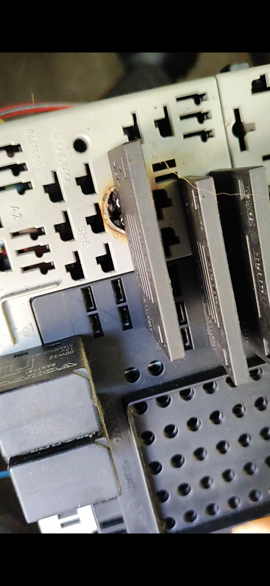

Well here's a picture of the CEM from under my dash

That melted connection on the shunt in the 4th position is for the low beams - Hopefully they are still working.
Yes they still work, I'm not sure what would cause that to heat up and melt the connection though. Do you have any ideas? Also I got my problem to go away not sure I fixed it though. I just pulled the ignition switch and tried hooking up the battery with the ignition switch out and no rear wiper running no lights stuck on. So now I reinstalled the ignition switch and now the car starts up no problem, no rear wiper stuck on and the lights are working properly. I'm not really sure what to think.
