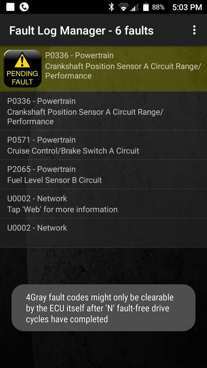

 inexpensive Bluetooth Scan Tool inexpensive Bluetooth Scan Tool
gives lots of codes when the car does not start.
After I clear the codes and it is warm outside, the codes do not return and the engine runs like a champ…so I think all these codes are simply related to the intermittent electrical problem that I suspect.

when a car has a voltage issue, its not uncommon to get all sorts of fault codes - comm errors etc. Best to do what you did and just record and clear to see what resets. Based on the codes you've shown, the crank position sensor is the one to keep an eye on. Its possible you have a cable issue - try cleaning and tightening the battery terminals. If your battery is over 4 years old, you may be on the borderline of needing a replacement - consider having it tested as well. Note that batteries are supposed to measure 12.6V when fully charged. if you measured 12.1 you may need to adjust your VOM or you could have a weak battery. Could also be an alternator issue not fully charging the battery so you may want to monitor during a driving cycle (your OBD reader can probably do this).
