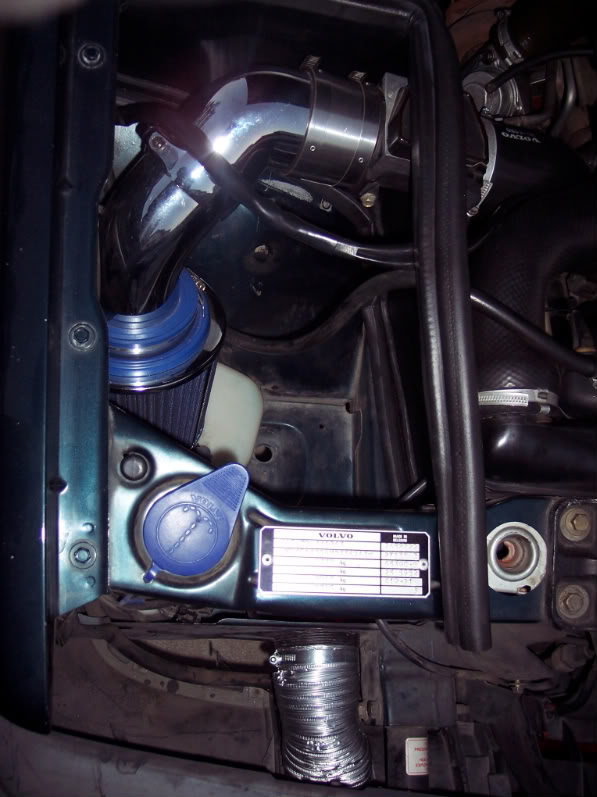

here is what I did.....
3" heatduct hose from the HomeDepot....$25 filter and $25 in pipes...
My $50 intake.....yeah....It is loud as Hell!
