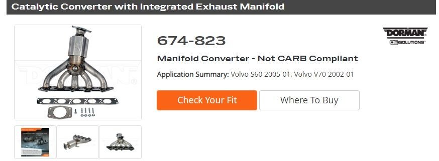

Some of the non turbo cars have the Catalytic converter built into the exhaust manifold. There are aftermarket solutions (that will work in most states - for a while at least)

Thanks, I just looked it up.
It says it's not legal to buy or use in California!?!?!
https://www.rockauto.com/en/moreinfo...8ySZlOPzEJUDWf
How am I supposed to fix this if its not even legal to use?

Correct, many aftermarket converters are not certified for use in California.(and some other states now) Most aftermarket converters use less precious metals in them (platinum, rhodium, palladium) - that's why they don't cost ~$1500 like some of the factory (certified for CA) converters do. And they don't tend to last very long either -
