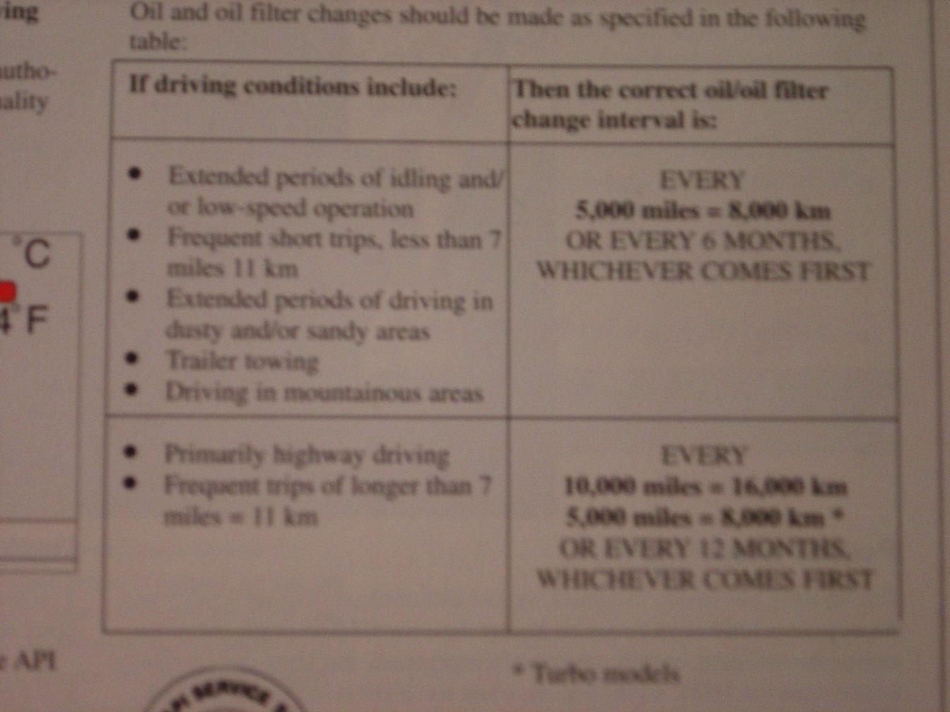

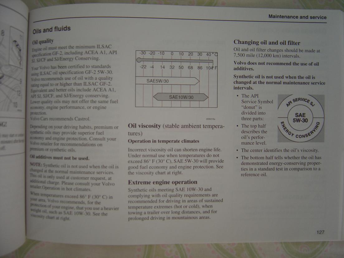

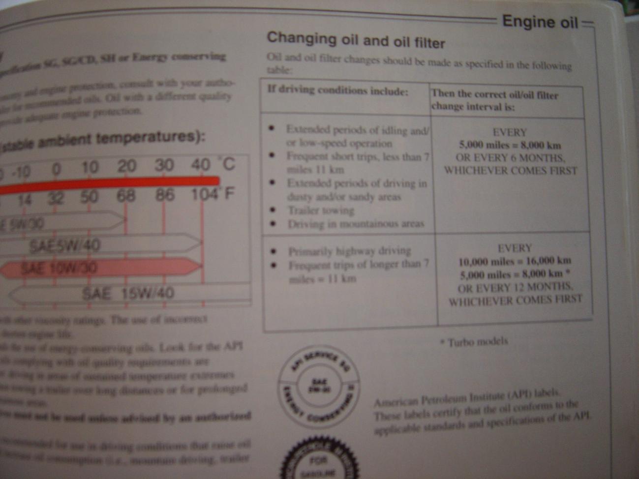

Volvo doesn't recommend using any oil additives!!!!!
Here are pics from owners manuals for 850 ans S60

Don't get offended mister. I didn't mean to say you were wrong. I didn't say don't do it it doesn't work. I just posted pictures from owners manuals because he doesn't have one. In there in bold letters they mention (couple times) not recommended to use additives. So now he knows what they recommend.
