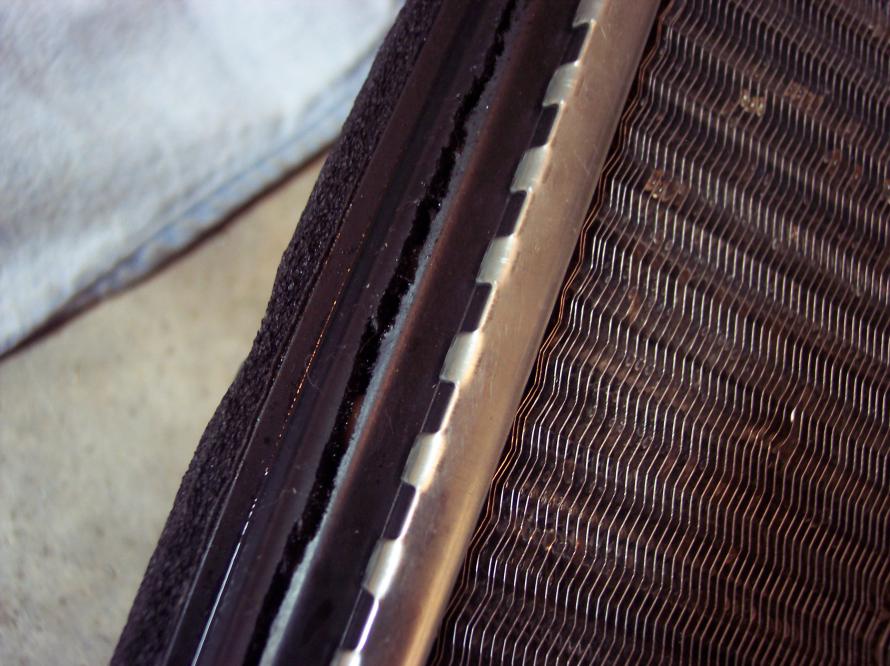

Just spent a whole lot of time rebuilding my 96 850 platinum edition's motor, turbo, suspension, radiator and heater core and put about100 very fun miles on her. The other night I took her out for a quick drive, backed her into the driveway let her idle a minute or two (very proud of my car as my neighbor told me how great she sounded, looked and fast she seemed) while I was checking a code, then turned her off to reset the code. A few minutes later "BOOM" huge stream venting through the dash, coolant pouring out on to the floor soaking the carpet, amplifier, etc.
Maybe it was my installation so get right to cleaning up and pulling the core. This is what I saw.
No over heating, installation looked great but the upper tank split

I took the failed core to work and had some Mechanical Engineers I work with evaluate and they gave me some very good ideas as to why it failed.
I now have a Behr that looks much better and will install this weekend.

10 days it was in the car and was okay, car ran great, drove her hard for over 100 miles and had so much fun. The car did get hot the day it failed as I learned after I installed a new Behr when the car got hot again. What could it be all things point to the Tstat that I didn't replace(hey it looked good and actually worked well for a few days). Pulled a brand new one out of my 96NA and put it in the turbo and everything seems okay.
Except that I still think the heater core should be robust enough to take a bit of heat and not be the weakest link in the system. So here are pics of a good core vs a bad core.
The Behr uses a nylon based plastic that is much stronger, especially at high temps, than the others ABS type tank( I can't say these are the exact plastic composition but this is what they look like to me and a few others). And note the added reinforcement webbing in the exact area that the previous tank failed. And if you look at the core dimensions and the passages 9 vs 11 in the behr (and many more fins as well). The behr is a superior product.
