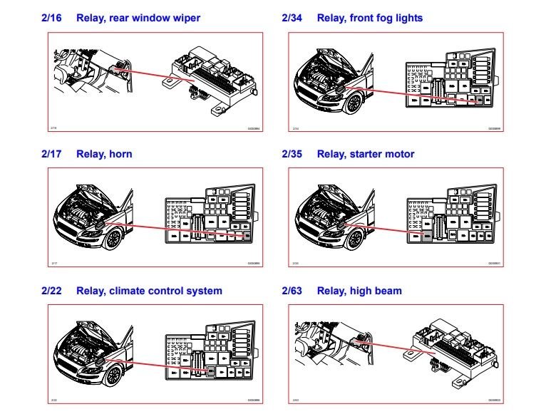

If you want to run the engine to diagnose your alternator you can manually engage the starter by using a jumper wire on the starter relay for fun - that will send current directly to the solenoid, on the wiring diagram 2/35 is the relay - 6/25 is the starter, relay location is shown in the fusebox under the hood. Make sure the car won't roll (it's in park, maybe brake on also) when trying to bypass the neutral safety switch.
