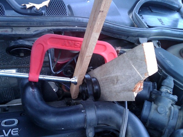

well it has a fresh OEM bushing, only took me and my friend about an hour and a half to get into place. and that includes the time it took to charge the drill :-D hahahaha....
no seriously... no joke...
i'll post a pic a little bit later of what i mean but it simply would not go into place and eventually i used two peices of wood and sanwiched the mount and the bushing with a C clamp to force it in, but the way the oem bushings portrude in the center was causing undue stress on it so i drilled a hole so that the center portusion could rest relatively stress free in the middle while the entire outer ring was being forced into the mount.
eh... maybee i will post that picture.. let me sync my phone... there we go looks crazy but it worked great :-D

Good job!!!!!!!
