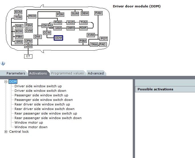

Possible bad DDM, driver door module. Do you have access to vida? If so you can try to move the window using that interface. Here's a screen shot of the activation choices.
