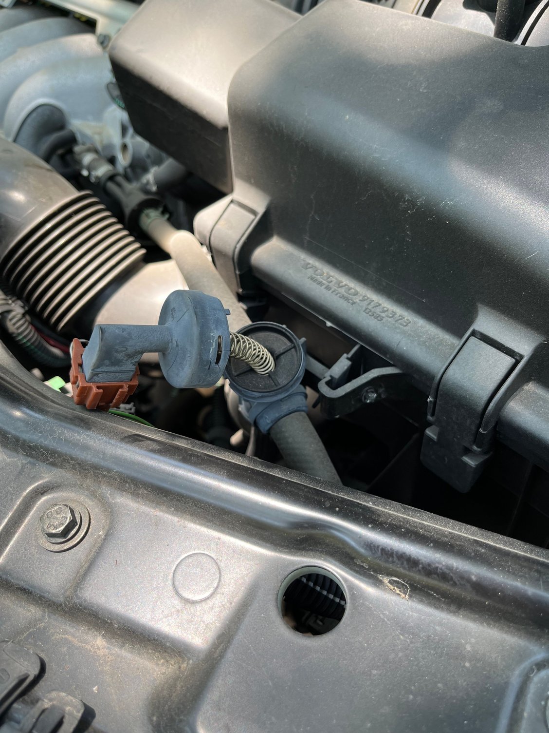

What is this called so I can get a new one??
Old May 14, 2024 | 12:55 PM
Cowtowndave's Avatar
Joined: May 2024
Default What is this called so I can get a new one??
2004 V70 base this at the front of the engine on the drivers side. Looks like the spring broke the weak plastic over time. Just want to know what it is so I can get a replacement part
thanks!!
Old May 14, 2024 | 01:17 PM

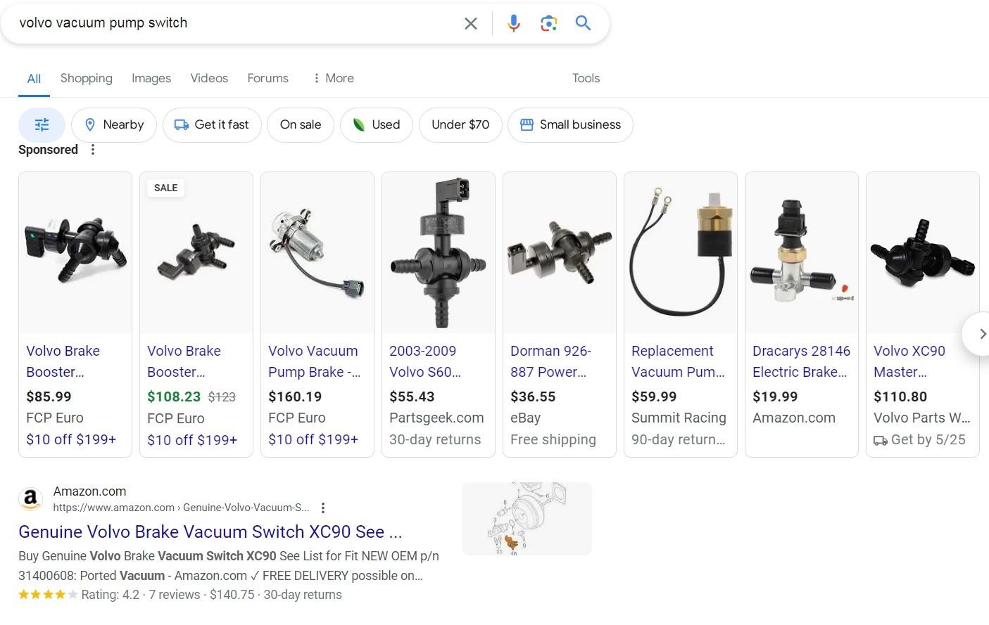

Commonly when that switch breaks - the vacuum pump stays on all the time, overheats, and seizes. I suggest you make sure the pump still works before replacing just the switch.
