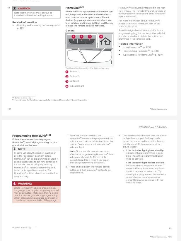

Originally Posted by matonanjin
Anyone know a reliable source on how to program the buttons on the mirror to sync (work) with one's garage door opener?
How about instructions from your owners manual - starting at about page 424
https://volvo.custhelp.com/app/manua...2020/model/S60

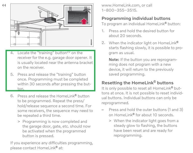

The page(s) you showed there demonstrate programming the Homelink from one's remote to the garage door opener. This is if the system in not a "rolling" system. The rolling system is one that the code constantly changes. Everybody now days has a rolling system. So one then continues to the
next page which discusses how to program a rolling system. I can't figure out how you attached the pages you did. But if you go to the very next page it has steps 4-6. Here is where I said in my OP that some instructions I found have one pressing the button 2 and 3 times.
THEN after doing this it says "Programming Individual buttons"!!! That's what I want to do is program and individual button!
Yes with a rolling code system you have to push a button on your garage door opener to be able to successfully make homelink work. And there is a 800 number for help listed also. (in the Volvo owners manual)
