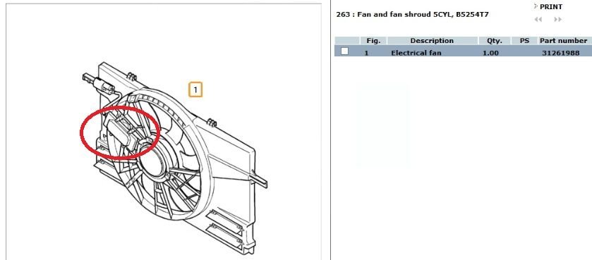

You might have a bad fan control unit. My old parts catalog shows it not sold by itself - but it may be available now from Volvo or aftermarket.
