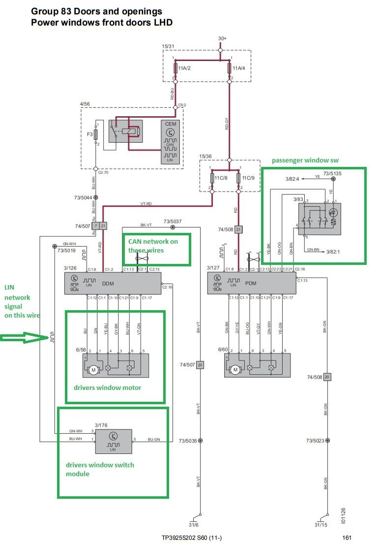

1. Mirror broken from accident
2. Body shop replaced mirror, put door back together - then tried to test mirror and it did not work?

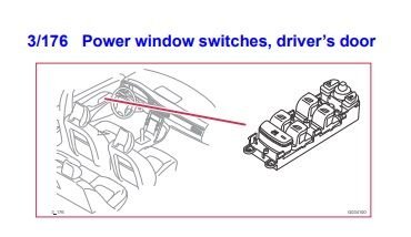

Did they take the door panel back off and double check their work, making sure the mirror is plugged into the DDM, and the drivers window switch was reconnected correctly? (if they unplugged the switch or jarred the connection loose while/after taking the door panel off/on) Are you certain the new mirror is the same type as the old? There are 3 available, manual or electric fold, w/wout BLIS.
The mirror wiring, drivers window switch, the drivers window motor and the lock/unlock switch all plug into the Drivers Door Module. (mounted under the door panel) The drivers window switch assembly is actually a LIN (local interconnect network) module connected to the drivers door module - meaning all of the instructions sent from the drivers switch for the 4 windows, window lock, mirrors is send over the LIN network wire. Versus the passenger (and rear) window switches being regular analog switches (with an easily traceable wire for each function) The door locking switches are analog also. Wiring diagram can be found at volvodiag.com

Hi. Thank you for your reply and the diagrams! I listed the events chronologically so, if your question is whether the body shop could've caused the issues, no, the windows and mirrors already weren't working. I'm not 100% on if the passenger side mirror stopped working when the driver side mirror was smashed or if it stopped working a few weeks later when the window issue began. I didn't notice the mirror problem until the windows stopped working, which was the day after I had cleaned out the car. I just assumed the two were related and that I had potentially knocked a connection loose somewhere when vacuuming. Would wiring under the seats or in the trunk have anything to do with windows and mirrors?
I don't know if the body shop reconnected the switch correctly but I chose them because they are Volvo-certified. I discussed the windows/mirror issues with them when I dropped it off. When I picked the car up a week later, they told me they weren't able to figure it out, they had checked things while the door panel was apart, ran computer diagnostics both before and after the mirror replacement but it didn't throw any related codes.
