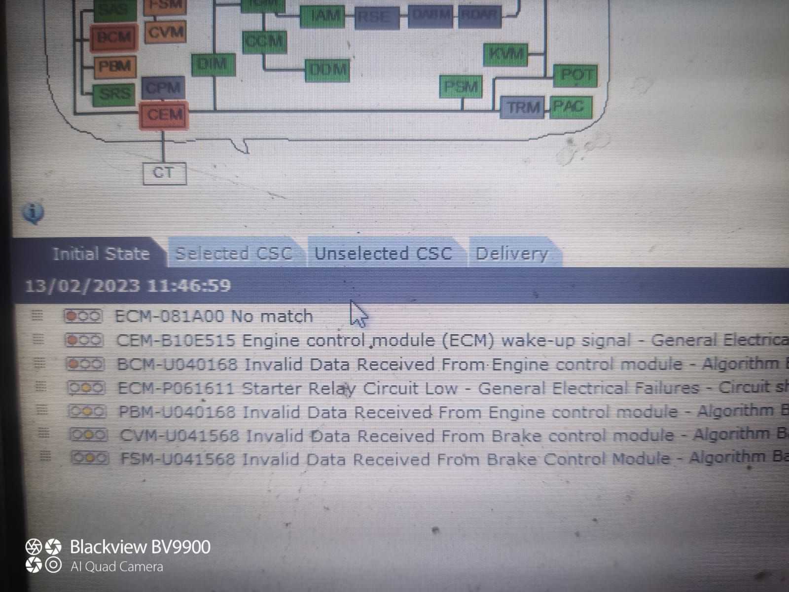

Old Feb 13, 2023 | 01:09 AM
dwi's Avatar
dwi
Joined: Jan 2023
The volvo can't start when I push start button engine not crank
we have repalced
1. starter relay
2. used ECM (including programed)
3. used CEM (including programed)
4. clean all ground point and all socket cable
DTC code ECM-081A00 (no match)
but engine can start with press brake pedal and connect dirctly cable from starter selenoid to port Positive battery
Has annyone ever had a problrm like this...? and how to fix it..?
