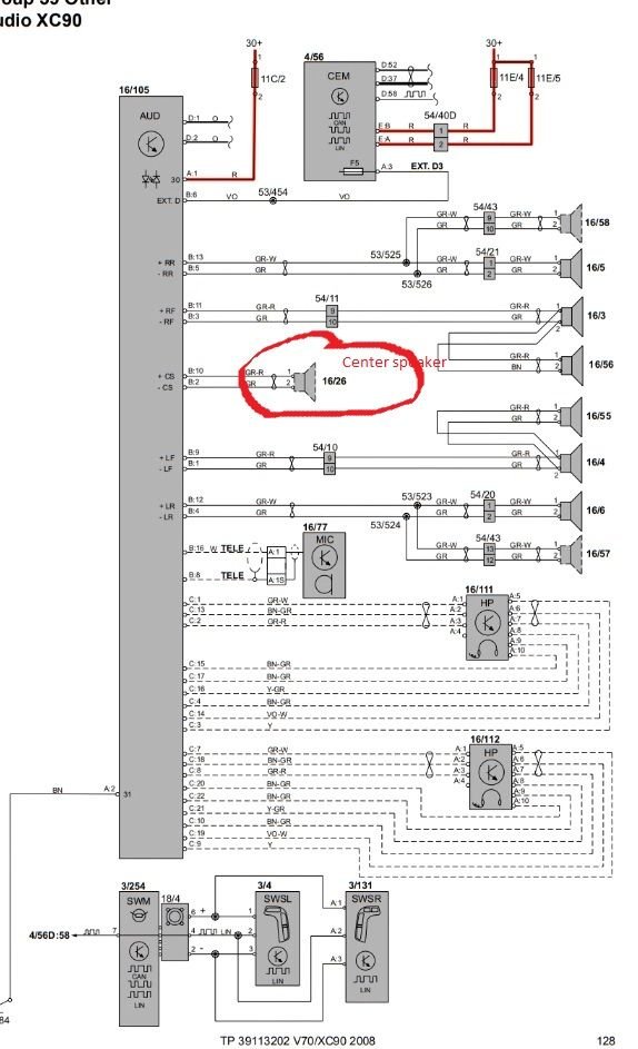

Exactly what part did you replace? The ICM or the AUD? If you need your ICM fixed or "coded" - these people can help with that https://xemodex.com/us/available-ser...rol-module-p2/
If you have a center dash speaker - all the speakers are powered by the audio module in the passenger floorboard. Those tend to get wet from the common water leaks that happen in xc90s - and fry. Here's a wiring diagram.
