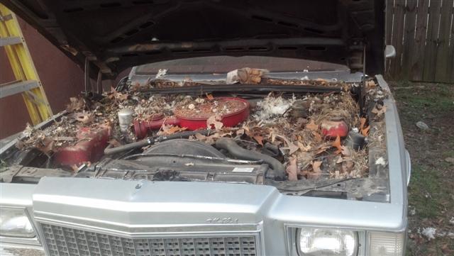

Default Rodents under the hood.
Ok, here is an example of what you don't want to happen. I have seen/heard of this happening several times over the past 2 years. People parking the car somewhere and not keeping the critters out.
I was talking to a friend of mine and he started talking about his '76 Monte Carlo. He was excited. Talked about it several minutes and he talked me into going to his place to see it and get it running. When I got there today, I seen the hood up just a little, unlatched. The car was sitting under a carport, looked like it had been there at least 2 years. He had a jump box sitting next to it, I guess he was thinking that we would fire it up and hear it run.
When I pulled the hood open, I seen this huge nest almost totally covering the engine bay. Then I seen a rat, about 8 inches long stick it's head up and stared at us. He didn't see it at first but finally did. Then it got up, walked across the motor and down the passenger side. The past few stories I seen like this resulted in the rats/rodents eating up the wires under the hood. Once he gets this one cleaned out, we'll see if this one is in the same condition.
