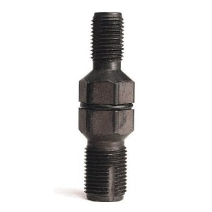

The threads should be the same as a spark plug. A spark plug thread chaser should do the trick to straighten them out. Most auto parts stores 4-8 bucks.
18mm X 1.5 is the common size.
If worse comes to worse you can also use a spark plugs heli-coil to repair the hole.

Ok, I'm going to go get this O2 sensor thread chaser to see if I can fix it with it. It cost just under $7.
Lisle 12230 - Oxygen Sensor Thread Chaser | O'Reilly Auto Parts

This thing is on top. I think what got me was the O2 ratchet adapter from AutoZone. Put the leverage about 2 inces off center. I got the chaser today and knocked out in about 10 minutes. However, the car doesn't seem to like the sensor. After driving about 25 miles it threw 3 more codes. I told the guy to drive about 400 miles to give the computer a chance to get use to the sensor (bosch) and see what's going on then. I'm going to move this thread to OFF TOPIC.
