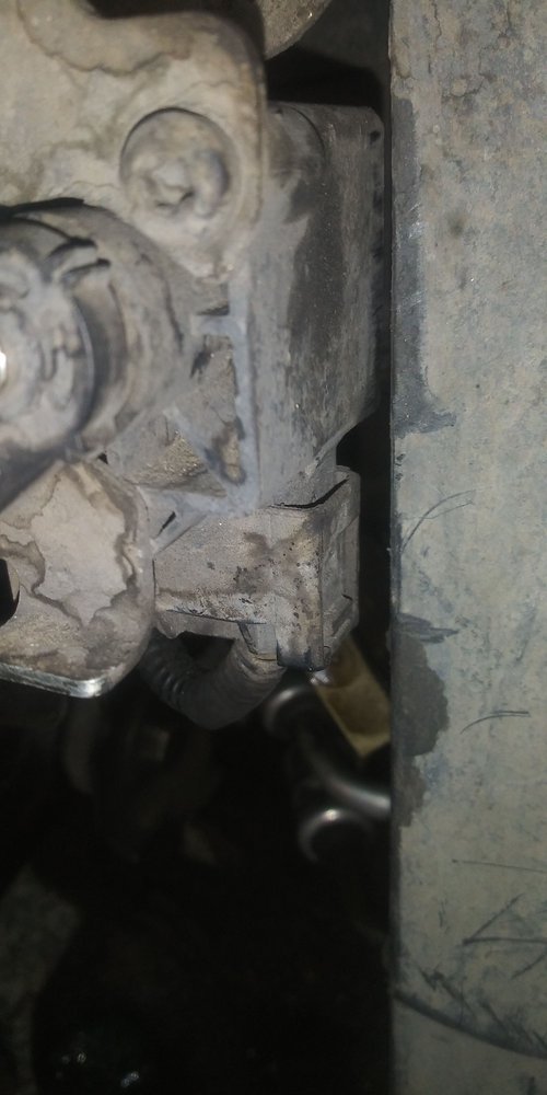

I have a 2007 c70 t5 and i hear a harsh clunking noise. Ive changed the cv axle and bearings hub. Now im lost. I was told
this part might be the culprit ( see photos) but i have no clue what it is and would it make that type of noise since it seems loose. Please help. Its very harsh in the cold morning and kind of stops when the day heats up. Your opinions are definitely valued. Thanks!

I think you were on the right track feeling for loose suspension and mount bushings. When the parts are cold the rubber in the bushings shrinks making the part loose and able to clunk. When they warm up the sound diminishes since the bushing expands (old trick for installing bushings inside a control arm is to put them in the freezer before installing) When does the thumping happen - going over bumps, while accellerating, when turning left or right?

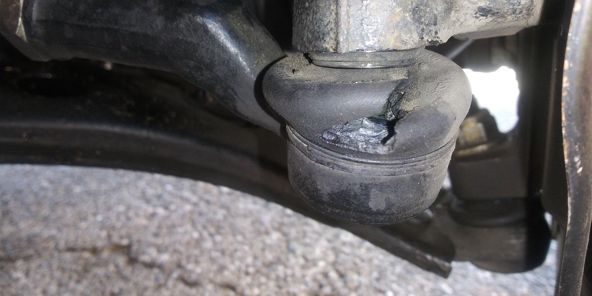

This is the only thing ive found worn. But everyone tells me if my tirea arent worn it shouldn't be the problem. Your opinion is definitely appreciated.
Front outer tie rod
Old Oct 23, 2019 | 03:32 PM
Likes: 541
any time the rubber boots on ball joints and axles etc get torn the grease can exit and dirt can enter. Its just a matter of time before the part fails. Best to get that part replaced and see if that does the trick.
