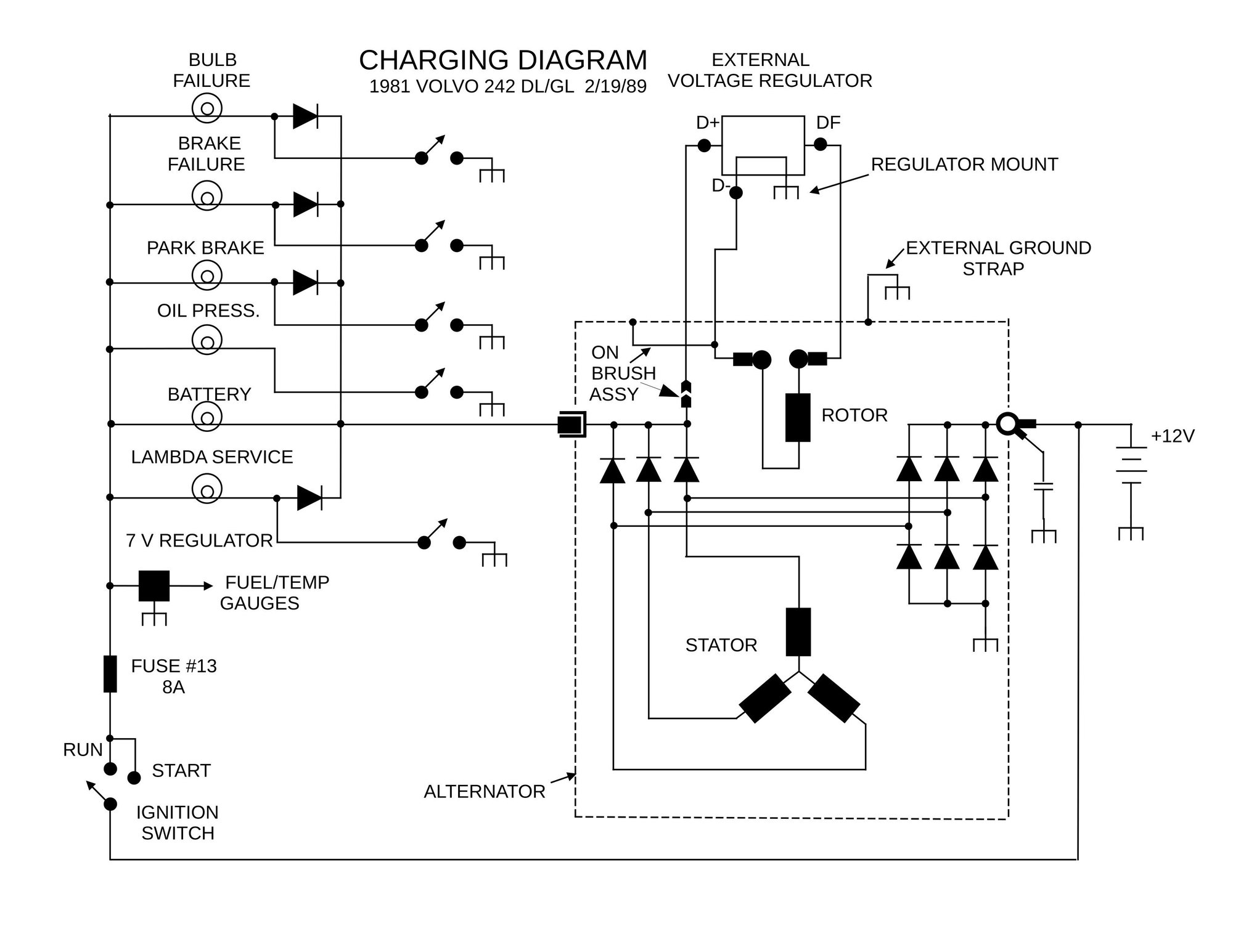

Hey All,
Helping my son work on his GT and hoping for some help. We had a series of events (dead battery, new battery, new battery dead) that lead us to picking up a new alternator. My son was putting the new one in and didn't pay attention to where the wires were going at first and ended up hooking the big red wire to the D+ port the first time we fired it up and tested it. We noticed the battery was not charging so I dug into the wiring and realized the mistake. We then moved the big red wire to the B+ terminal and the small red one to the D+ terminal. The car starts up but is not charging. I test voltage on the D+ terminal and get ~1 volt when the key is in the 2 position and ~6.6 volts when the car is running. Did we ruin the new alternator with the first round of wiring or is there something else we should look at?
Thanks for your help!
Nathan

You did not mention the third wire - A 240 alternator is mounted in rubber bushings - so there is a ground wire attached near the bottom of the alternator to the engine block - Is that attached? Without the ground wire - the alternator will not charge.

Since both outputs are 12-14V I dont think any damage was done.
Since both outputs are 12-14V I don't think any damage was done.
I would hook everything up correctly. Turn the key on and measure the voltage at the small wire output. It should be 12V. If not check fuse 13. If ok try to start the car, and see if everything works.
If not measure voltage at both the large and small outputs. Both should be 12-14V.

Does the battery light on the dash light up when you turn the key to the II position (engine not running)? This bulb needs to be functioning in order for the alternator to start charging.

Finally got to do some more testing last night and figured out the AMP light does come on with the key in the II position and also stays on when the car is running. Bad alternator then?
Old Jan 30, 2025 | 11:10 AM
Yes ---
