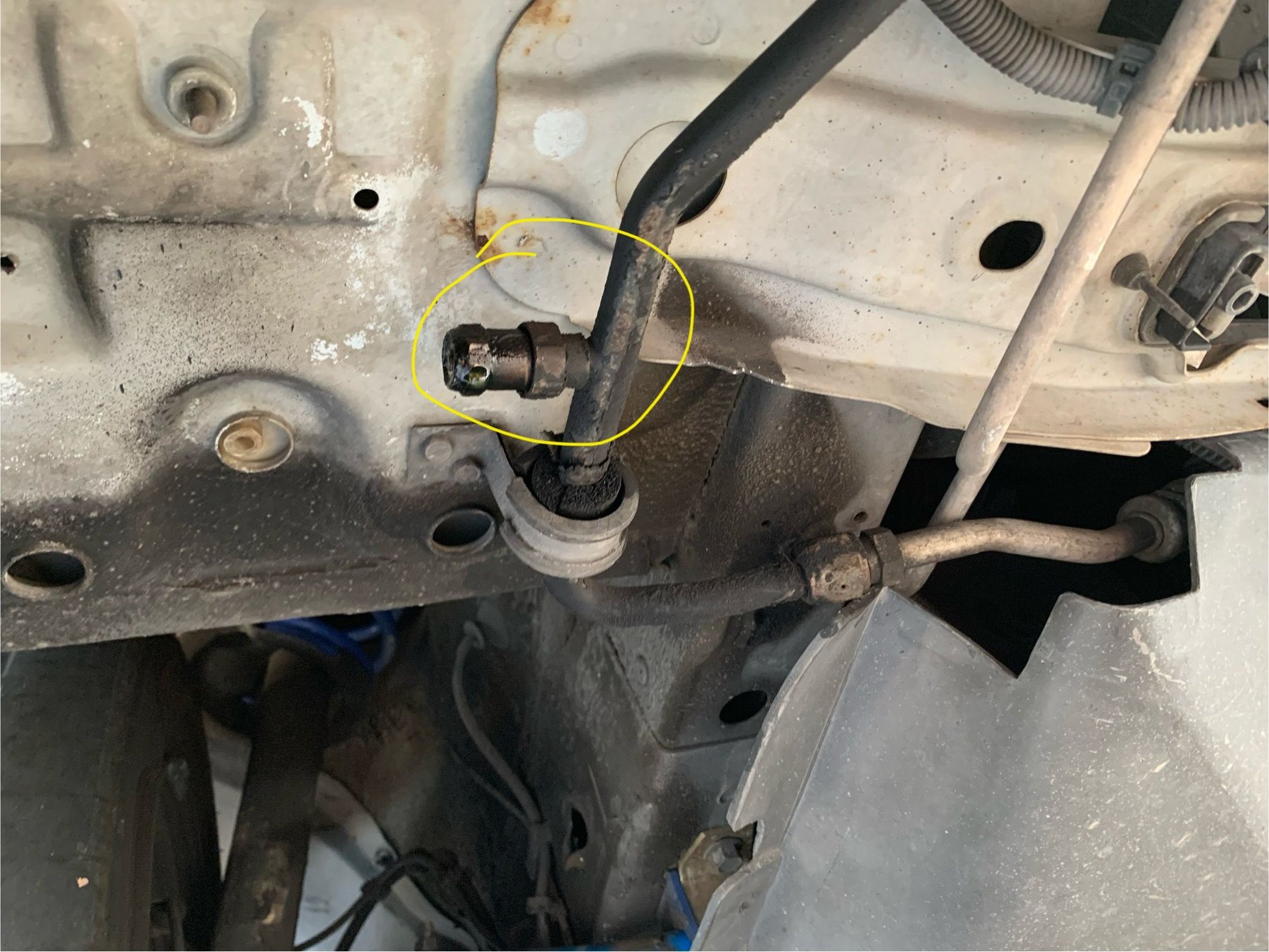

Default 1992 940 B230f AC leak
Have a bad AC leak on the passenger side about under where the headlight is. Not really sure but it doesn't seem like a service port. Found it was loose so I tightened it but it still leaked. Opened it up and there was a metal gasket and I couldn't find any other gaskets that would work. Does anyone know where I might find gaskets for this? Or even just an outright replacement in case? Thanks
Old May 28, 2025 | 08:59 AM
If you can find one - it's a pressure relief valve 3522398
https://www.rendcarparts.com/parts-f...2398/RD3522398
