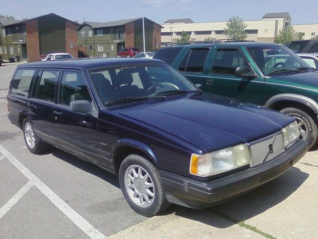

Default here she blows
Got this for my gf from a guy in derby, ks for 600$. put a battery in it and turbo rebuilt. he didn't even know it was a turbo. so all in all i'm in for about 900-1000 dollars. not too bad i dont think. and she likes it and its safe so i'm happy. thanks erbody.

You are letting your girfriend drive a $600 car?...J/K...she's lucky she has a car and yes it's a good deal if it runs...

I think the 940 Turbo wagon is a thing of beauty. My '94 still turns heads, either in amazement at the body lines or wonderment why I would ever drive something like that. You bought a true classic and worth putting the time into.
