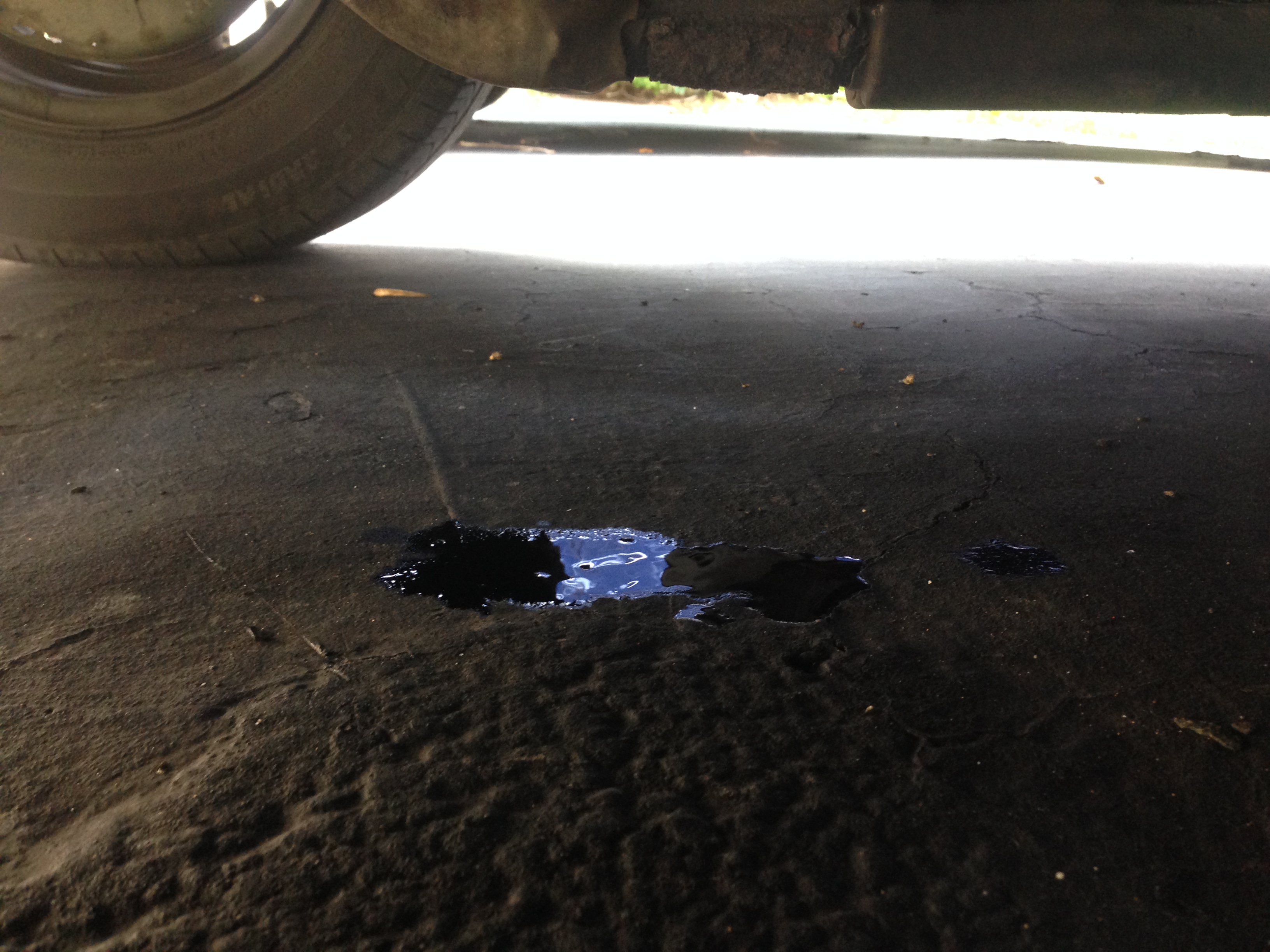

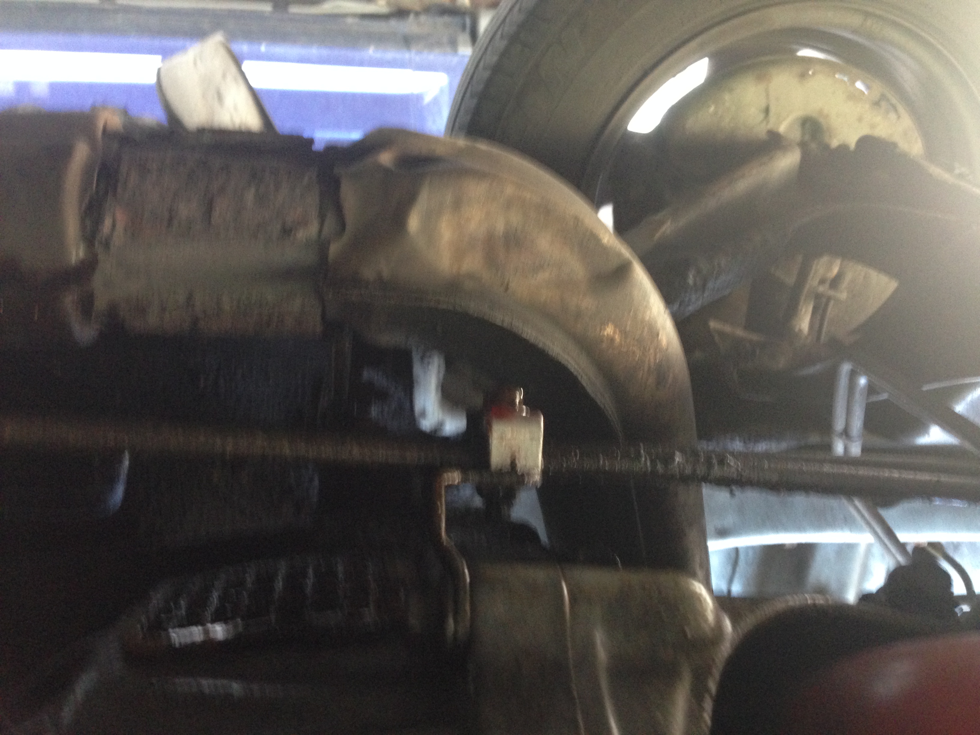

Started crawling around underneath and spotted this...for the first time ever. It looks like ATF? Could this be the heater lines leaking? I ran my heater for about 2 minutes of my drive. Wondering if this is burning off and I notice it while sitting still?
Anyway, apparently I need to replace seals. Sorry for the crappy phone pics

that first pic is too fuzzy to see what it is. the 2nd pic looks more like oil than coolant, I'd dab a finger in it, then sniff it and rub it together to see what it is. ATF is red, engine oil is yellow or brown, coolant is water based and depending on your brand of antifreeze could be pale yellow (G05) or green (volvo brand or generic grade junk) or some other color.

I just stood on my head and looked at the first pic. That is red ATF. That will cause smoke hitting that exhaust right there!
Only thing that could really be leaking right there is the input shaft seal. Time to pull the tranny!

Thanks, Revolv. It is definitely red ATF. Is it possible that it's from the heater lines? The only time it leaked enough to leave a small puddle was when I ran the heater. I just drove 30 minutes with no heat and when I parked, no puddle over an hours time.

the heater hoses carry coolant, you blow one of those, all your coolant is lost, and if you don't shut down immediately, you run the risk of overheating and blowing the head gasket..
there is a pair of transmission cooler lines from the tranny to the radiator and back, those carry ATF, in fact I think thats the horizontal pipe visible in your first pic.

the photo is too motionblurred and out of focus to tell for sure, but there's a lot of crud on those tranny cooler lines, its possible one has corroded through... i'd clean those up (brush, hose, then spray with gunk engine cleaner, let soak, brush again and hose off), then run the car for a short bit and see if the ATF is coming from the cooler line, or the tranny itself...

Think it's fixed (not the picture). The transmission cooling hard lines were leaking. I cut a few inches out of each and fit some rubber hose and clamps. Hopefully should be good to go. Thanks for the help!
