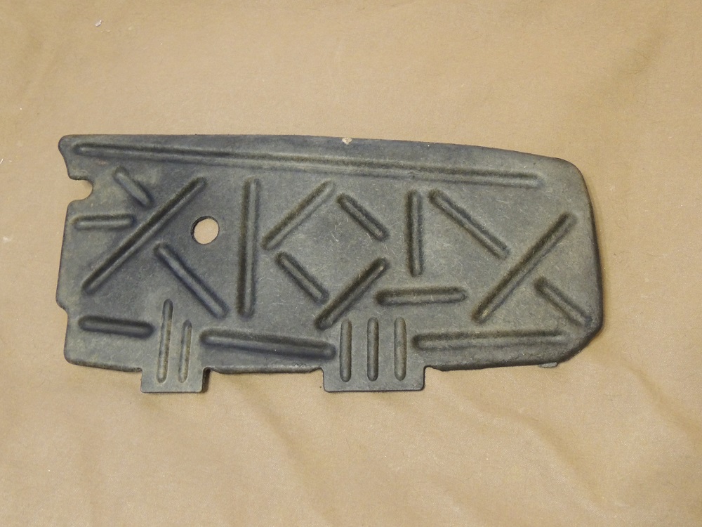

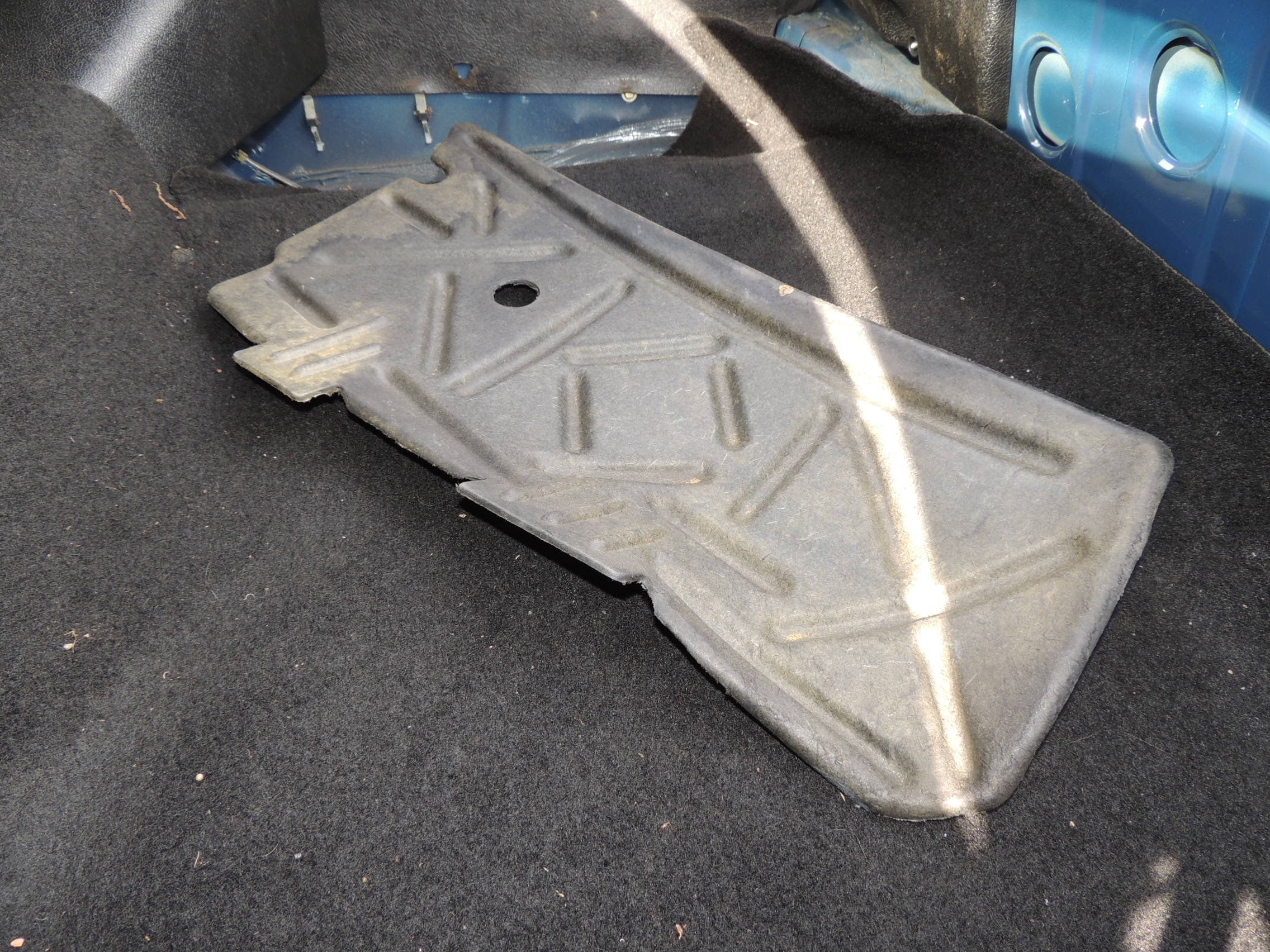

On my 240DL the panel that covers the right wheel well was all sorts of warped out of shape. Looking at the panel I couldn't tell if it was made out of a fiber reinforced plastic or was some sort of fiber reinforced "paper" type material. I did find that you can purchase a new panel made out of fiberglass for $39.00, but I wanted to see if I could save mine first.

I conducted a simple test under the kitchen facet and found that whatever this is made out of it absorbs water.
I soaked the entire cover in hot water and it actually because pretty pliable. I was worried about the material "swelling" like fiber board will do when it gets wet, but that didn't happen.
After giving it a good soaking I sat it on the floor on a towel and put some weight on it with the hope that as the panel dries it would hold a flatter shape.

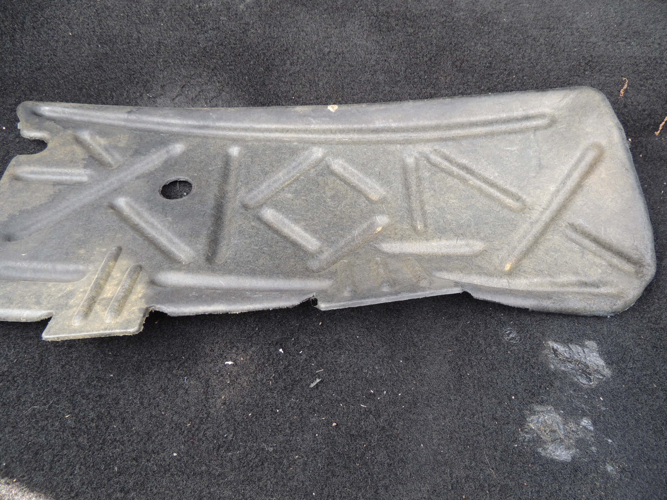

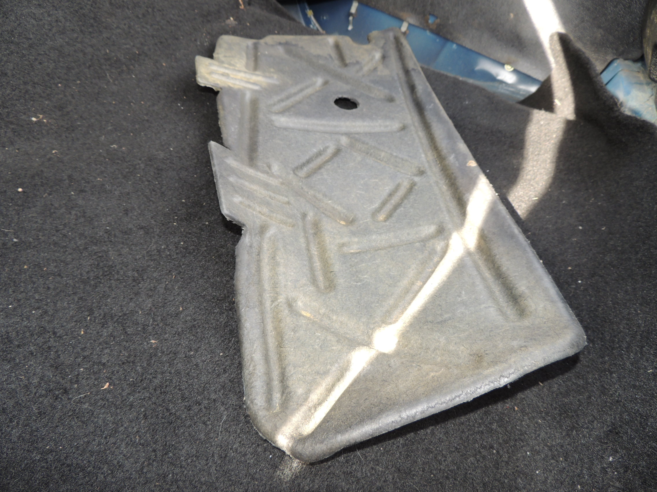

After letting it sit overnight I removed the weight and the panel stayed flat. It still needs a bit longer with the weight to fully dry, but it seems I have removed the warps and twists that were in the panel.
Once fully dry I plan on coating the panel with probably a fiberglass resin or something similar to stop moisture from getting back in and causing it to warp like it did in the first place.

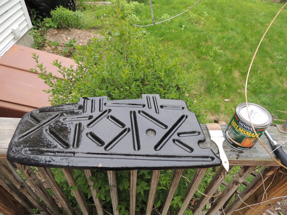

I figured if water getting into the fibers caused the warp then keeping water out after straightening it can't hurt.
