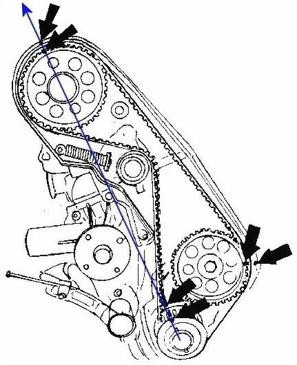

This is definitely not a fuel-related issue. First of all I started pulling spark plugs and each one was gas fouled. Further, I cheated and sprayed a little ether down each plug hole before replacing the plugs and apart from a slight pop, nothing. It should have caught with a little ether.
I'm beginning to wonder if the timing belt jumped a tooth. It is the one thing I can't 100% vouch for. The crankshaft and the distributor seem to line up properly and everything is turning as it should, but I didn't pull the cam cover to confirm complete alignment. The other thing I'm noticing is that when I crank the motor it sure is rocking from side to side. I know that this is an interference motor, and at no time did I hear anything metallic to indicate that I had valve to piston contact. It isn't a Diesel, so I assume that jumping one tooth wouldn't necessarily mean disaster.

Its non-interference. Are you sure you have spark?

I thought I read somewhere that this was an interference motor so I'm glad to hear that it isn't. Early on in this process I tested for and was getting spark. I also know the cam is turning because while I was checking the engine actually started, spraying oil from the open filler cap. At that time I was even able to set the base timing with a timing light. The violent shaking when turning over and the occasional pop when I release the key tells me that things are happening, just not at right time. I replaced the distributor thinking that there was an intermittent spark issue.

See attached ... I would double check the wires are in the correct order.

Thanks for the image. I have a Bentley and I've done timing belts on other cars before. If you are referring to the ignition wires they haven't been moved since the car was last running. Seems like a cheap thing to take everything apart, confirm the timing marks are still lined up, and throw in a belt as a precaution.
