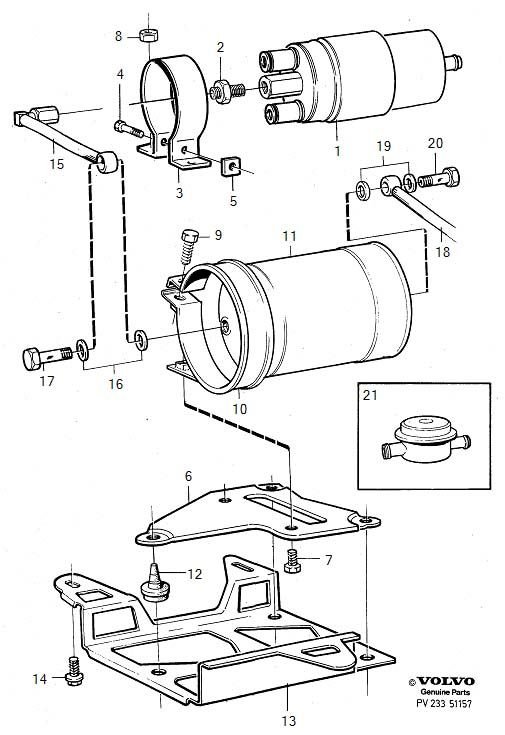

vacuum sealing?? that main fuel line is under 40 or so PSI of pressure, if its leaking, fuel would be spraying out all over, ka-WHUMP, your car would burn to the ground.
the main fuel line from the filter to the fuel rai is, I believe, 1342033, but I seriously doubt that is available any more, more likely you'll need to fabricate something, perhaps using copper-nickle brake line, and suitable metric banjo fitting at the fuel pump, and a flare fitting at the fuel rail.
lack of fuel pressure at start is more likely to be the 'non-return valve' on the output of the fuel pump, 1326899... thats part #2 on this drawing... (the fuel line above is #18)

the check valve is actually between the main fuel pump and the filter, as shown by #2 on the diagram I posted above.
Old Jan 13, 2020 | 10:54 PM
the test for this check aka non-return valve is to hook up a fuel pressure gauge to the main fuel rail, and run the pumps, you should see the proper fuel pressure (42-44 PSI minus the manifold vacuum of 0-9 PSI). now switch the fuel pumps off. the pressure should hold for several minutes at least if the check valve is good. if the pressure drops immediately, the check valve is bad.
